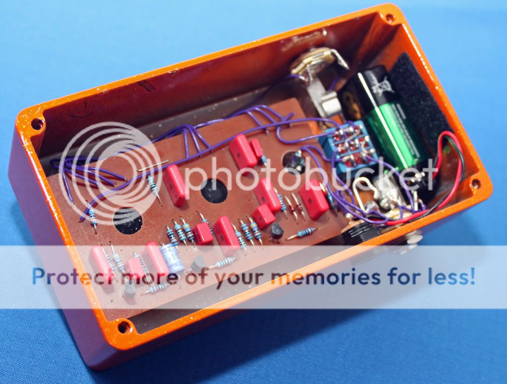

Re: B&M Sola Sound - Fuzz Unit
PostPosted: 08 Oct 2010, 20:34
by thorpy6
built one of these (actually two the same) using peps boards for myself,
Here is some pics. Sounds great and well worth the effort. The mojo of the original looking boards just adds to the sound :D :D
Cheers Peps!!
