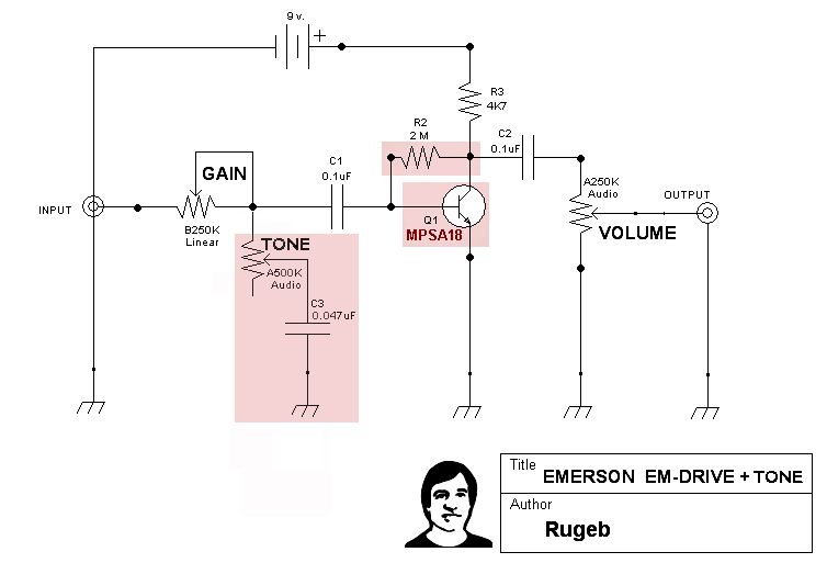

Re: Emerson Custom Guitars E-M Drive. [traced]
I've tried connecting 2M resistor like in Rugeb's schematic and tried BS170 and MPSA18 like he suggested. To me, the circuit became much more clean and it doesn't distort much at the maxed gain settings. I guess this can be an improvement if you are looking for super clean boost. But I'm looking fo...
I've tried with BS170 (MOSFET) has worked well, sounds good too: RECOMMENDED!
- 26 Feb 2013, 11:29
- Topic: Emerson Custom Guitars E-M Drive. [traced]
- Replies: 84
Schematic with TONE CONTROL: sounds good! a very important improved.
IMPROVEMENT: resistor R2 connected over collector-base and Q1=MPSA18: sounds very good!

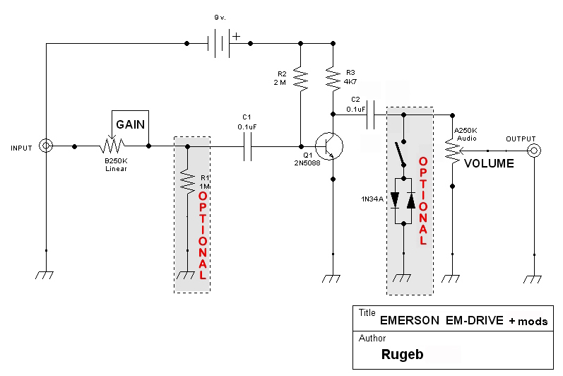

Schematic with mods: Pulldown resistor (anti-pop) and clipping diodes (for transistor amps):

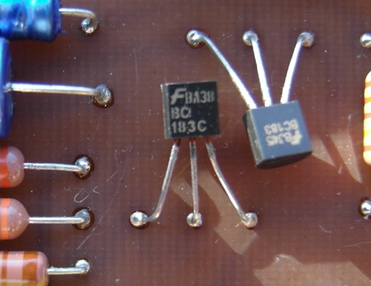

Re: Dunlop - Eric Johnson Signature Fuzz Face EJF1 [traced]
The original transistors: BC183 and BC183C :TheLemon wrote:Here you go! https://i1199.photobucket.com/albums/aa ... ences1.jpgokgb wrote:Is there a summary of what parts make the EJ circuit different ? , not many parts so it can't be much ?
