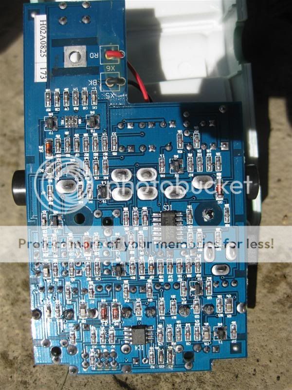

Just a couple of quick gut shots, got this green case UF100 second-hand yesterday.
The active element is the good old MN3207, or in this case CD3207, with MN3102 , or in this case CD3102, clock.
I haven't been able to track down a schematic, and I want to adjust something as the sweep seems unbalanced - three trimpots without function marked.
Maybe mo' better shots later if anyone gives a damn. I have higher res but no hosting.

Maybe a Boss HF-2 copy?
Posts: 4513
Has thanked: 568 times
it's a Boss BF2 flanger clone :wink:

That's bizarre, I was sure I'd posted a reply to say
"Never mind,
1. It looks like it's a BF-2 clone
2. The imbalance in the sweep was due to the setting of the 'Manual' control"
but I guess I composed a reply and then failed to post when my wireless connection died.
Thanks for your responses.
I don't know that I like the way the "manual" feature works WITH the sweep. I'm used to my homebuilt Electric Mistress clone(ish) where the functions are separate (toggle switch).

what's the function of the switch? I don't remember any switch on the BF-2
xerox
Posts: 46
Joined: 08 Nov 2007, 09:45
Post by xerox »
It's a polarity switch for the feedback knob I belive.
