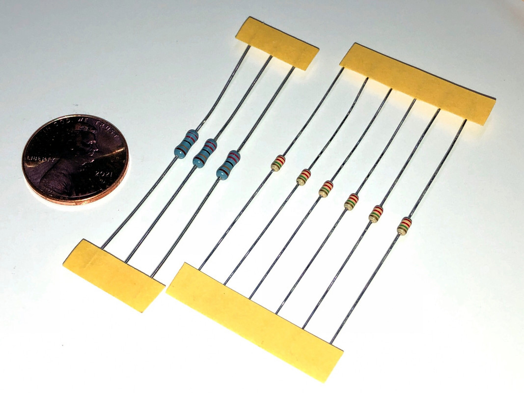

Lastly - either I got really old or some of the parts got really small!

A picture of the parts you received? It might be that there 1/8watt resistors on the bom, which are about half the size of the more common 1/4watt ones

Definitely smaller...
