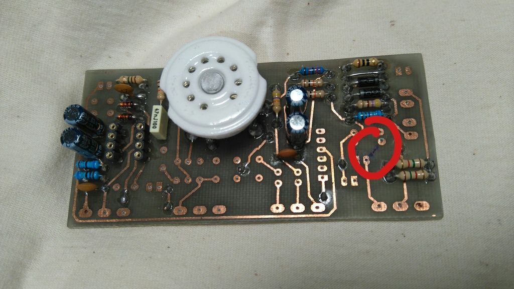

Hi,you have to check the connection of the wires to the pot ,one is going to ground.....
tonyamme
Posts: 2
Joined: 23 Nov 2016, 14:43
Post by tonyamme »
tip142 wrote:Hi,you have to check the connection of the wires to the pot ,one is going to ground.....
I finally found the mistake: pratically a trace is missing on top layer. I post a pic of new incomplete project to indicate missing trace that i have seen on original pcb.
Anyway i thank you all for support
