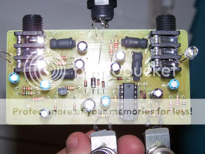

so i finally got it all built using roll-your-own photocouplers. I used these LEDs:
http://www.smallbearelec.com/Detail.bok ... s=9ba4a822
and these LDRs (the 8002 part):
First I fired it up and the CMOS got SMOOOOKING hot! realized i had it in backwards. Assuming it was fried, I replaced it with a new one. But I can't get either of the LEDs to light up. I just plugged it in without input on it or anything, just trying to validate my switching. I will wire up the input jack and get an audio test, but for right now it looks like my build is non-functioning :(
Are there any other parts that i could have fried by putting the 4069 in backwards?
post some pictures - then we can help you :wink:

As promised...
one thing I can see straight away - the extreme right diode is the wrong way around.
