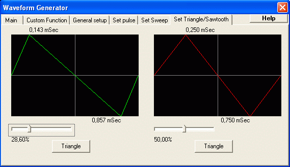

I get the idea, but don't understand how it's done hardware-wise. Could somebody explain how to hook up the circuit to the soundcard?

If you'd like to use the software function generator first mute the Line In in the soundcards playback mixer.
Then:
- connect the line out to your FX input
- connect the output of your FX to the line input of the souncard.
To mimic the guitar amp input and to protect the lineIn on the soudcard i'd use some opamp based 1M input Z buffer with protection diodes, or even better - instead of the 1M resistor i'd use a 1M log pot to have the input level control.
I'm using the VisualAnalyser for some time and it's simply great for developing low frequency (<audio band) circuits.

I too have been trying to figure this out.
So your saying you connect the Line Out on the computer to the FX input.
Connect the FX output to the Line Input of the soundcard/computer.
I thought I would try to use my audio interface (Tascam US-122L) with a guitar cable I clipped off one end and put an alligator clip on the ground and a probe on the tip. I clipped the alligator clip to the ground and probed around with the probe. It almost seems to work. Am I completely off by doing this? I am getting readings but nothing like a square wave or anything. Do I need to put a signal through the circuit? I did power the circuit up with a battery. Sorry, I never used an oscilloscope before. There doesn't seem to be much instruction on how to actually use it or hook it up.

If you are planning to use the built-in Waveform Generator, yes.Bside2234 wrote:I too have been trying to figure this out.
As the links on the site for bigger pictures don't work (they refer to local drives), here are the correct links for the pics if you're browsing:
http://www.sillanumsoft.org/images/scope.gif
http://www.sillanumsoft.org/images/spectrum.gif
http://www.sillanumsoft.org/images/Generator1.gif
http://www.sillanumsoft.org/images/Generator2.gif
You can put a signal through the circuit using the Waveform Generator, or you can connect something else to the effect input to provide a signal.I thought I would try to use my audio interface (Tascam US-122L) with a guitar cable I clipped off one end and put an alligator clip on the ground and a probe on the tip. I clipped the alligator clip to the ground and probed around with the probe. It almost seems to work. Am I completely off by doing this? I am getting readings but nothing like a square wave or anything. Do I need to put a signal through the circuit? I did power the circuit up with a battery. Sorry, I never used an oscilloscope before. There doesn't seem to be much instruction on how to actually use it or hook it up.
Hope that helps.
