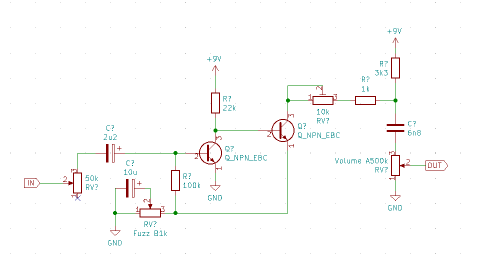

Here's the schematic. Maybe another pair of eyes can tell whether it's correct.
DjPsychic wrote: 16 Nov 2020, 12:02 The T2 & T3 refer to the 10k trimpot legs. They can be anywhere on those tracks. I usually connect "T1 & T3" together.
Your numbering scheme is a bit odd; the wiper is usually leg 2 (not 1).

rockola wrote: 16 Nov 2020, 17:13 Here's the schematic. Maybe another pair of eyes can tell whether it's correct.
Also thank you very much for drawing out that schematic

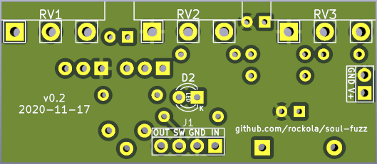

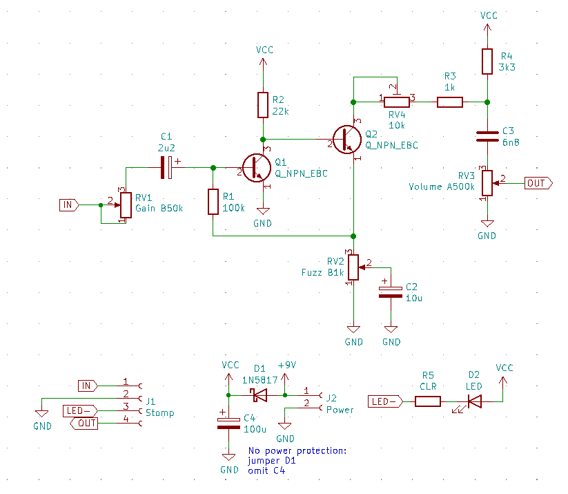

OK, my initial stab at laying out the PCB is at https://github.com/rockola/soul-fuzz
I took the liberty of adding stomp/power connections, polarity protection, and a LED. Also connected leg 1 of what I am assuming to be a gain pot (RV1) to the wiper. Here's the schematic as it stands now:
There are Gerbers but I wouldn't send them off just yet (edit: also looks like there's something wrong with the Gerber silkscreen layer, so hold your horses) until someone else has taken a look. For instance, I haven't actually gone through the schematic to verify that it makes sense, I just drew what was on the layout.
For anyone who wants to tinker with this, it was done with the latest nightly of KiCAD so keep that in mind (you won't be able to open it in an earlier version of KiCAD).

"RV1" is not gain, it's based on the fuller 69 "bias" pot. Just a cleanup at the input. That looks great. I won't send off just yet curious to see what others come up with as well. Thanks man!
and future versions I'd most likely skip LED. Less drilling :)

DjPsychic wrote: 17 Nov 2020, 10:56 "RV1" is not gain, it's based on the fuller 69 "bias" pot.
This is in fact the same circuit as Fulltone 69 (= generalguitargadgets Boutique Late 60s NPN Fuzz Face), with a few component value changes and omissions (no Contour pot).

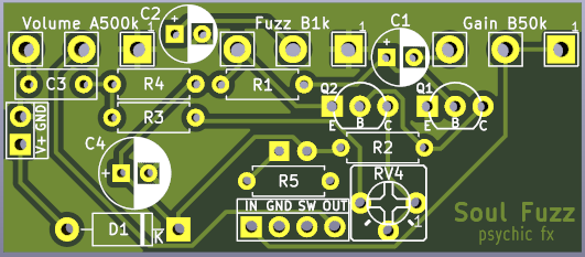

PCB to follow....
Edit - Forgot to ground C2 and the Fuzz pot... Whoops.... Fixed

Toner transfer PDF's
WARNING - This is not verified yet. I have one with a ground plane also if anyone is intrested.
PCB_SOUL FUZZ - NO GROUND PLANE - TOP SILK + BOTTOM LAYER.pdf
(41.01 KiB) Downloaded 13 times

So I put this on the breadboard.... It works.... sort of. It draws 110mA which is crazy. Battery will not last very long at that current. I think the common emitter stage needs a resistor to base from a vcc/2 node (which dosent exist). Im off to work but will mess around with it later. That 1k on the Vero is confusing me.... Isnt it connected to itself?
DjPsychic
Posts: 51
Joined: 07 Feb 2020, 21:35
Been thanked: 13 times
Post by DjPsychic »
Lani wrote: 20 Nov 2020, 12:55 So I put this on the breadboard.... It works.... sort of. It draws 110mA which is crazy. Battery will not last very long at that current. I think the common emitter stage needs a resistor to base from a vcc/2 node (which dosent exist). Im off to work but will mess around with it later. That 1k on the Vero is confusing me.... Isnt it connected to itself?
The 1k connects to the trimpot which connects to collector of Q2
