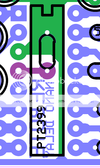

Just a couple of thoughts to ponder on multiple PT2399 delays:
- it would appear from recent reseach that pins 3 and 4 are connected internally by a low value resistor. If you look at the example circuits on the PT2399 datasheet, the delay pot is connected to digital ground. So maybe connect the delay pot between pins 4 and 6, with no direct connection between pin 4 and ground. Might help with sound quality.
- it would further appear from recent reseach that the PT2399 dumps a load of hash into the 5v supply rail, so the 5v supply rail should not really be used as a convenient vref for other stuff (not that cpm has done this). So, as the PT2399 is dumping hash - would it not make sense in a multiple PT2399 delay to use a seperate 7805 for each PT2399, thus further isolating and reducing hash?
ALDOUSCROSS
Posts: 27
Joined: 13 Jun 2009, 03:55
Post by ALDOUSCROSS »
frequencycentral wrote:Just a couple of thoughts to ponder on multiple PT2399 delays:
yup FC you're right. this pin is a digital ground. tried it on my ReboteDelay 2.5 design. and compared it with the ones i didn't isolated. and yeah at high volume/gain setting of my amp and dirts it can be heared. and this one here sounds a bit silent. and the delay is ambient IMO. here it is. i tried putting a lower value resistor. to alter it.
purple is my DigitalGround and gree is my AnalogGround
this alteration of grounds is also used on CPU motherboards. and mobile phones, which uses Digital and analog circuits.
I forgot, about using separate 7805s in this one i think wouldnt affect anything if you properly bypassed each power pins.(putting a bypass/filter capacitor at each IC's power pin.). and the current of course.

If I'm not mistaken Brian (madbean) also utilized digital ground on his Mad Professor Deep Blue Delay boards for that exact reason.

2. I haven't used the PT2399 in any project yet and don't understand how the ground connections work here:
- What is the difference between AGND and 0V? Do they just eventually connect to each other at DC_AGND (and is this the negative terminal of the battery )?
- Where does DGND eventually get connected to? Does it connect somehow/somewhere to AGND?
- Where do the audio input/output grounds (and the enclosure itself) get connected to, AGND?

- "AGND" and "0v" is a method to separate digital from analog ground on the schematic software. They should be joined, usually the DC suply or main filter cap, sort of "star ground"
- DGND is the label for the 1/2 rail, which is buffered by the opamp. This is reference voltage for biasing several stages.
- External ground, and chasis should be connected to the most stable ground, which sould be the DC supply or the filter cap.
