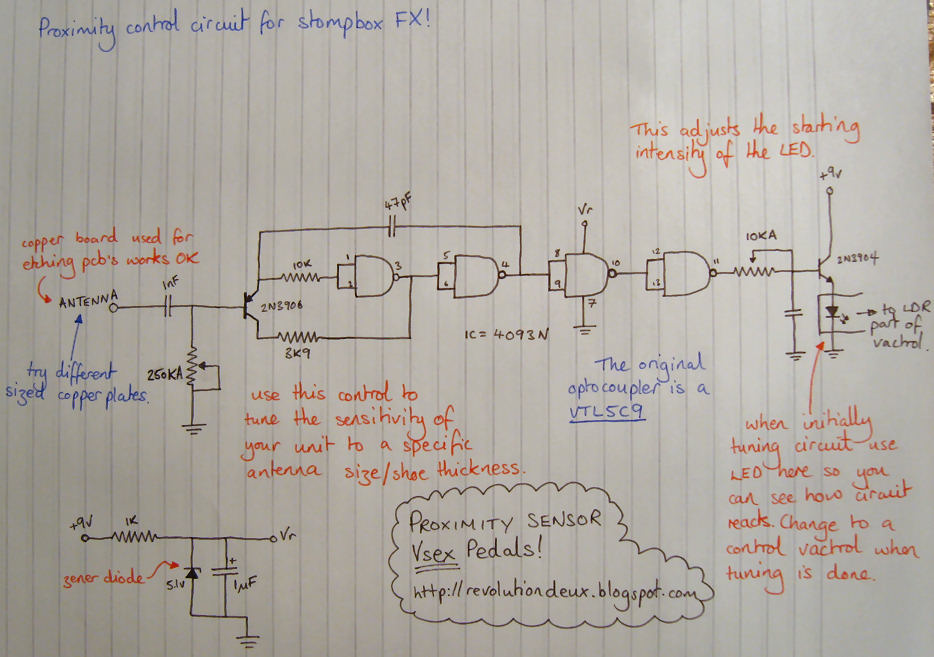

I’ve made proximity sensor with this layout (https://diyguitarfreak.files.wordpress.c ... ayouts.gif), but i have a problem.
LED lights only when I touch battery and plate in the same time. When they’re untouched LED is completely dark. I’ve checked it witch many trimpots settings. I’ve double-checked layout and componenents. I use HCF4093BE, 7,5V zener (tried also with 5,1V and without zener at all – same effect), 2N3904, 2N3906, ceramic 1nF and 47pF caps. Plate is copper PCB (9x12cm). When I touch pin 11 of IC circuit starts working properly (range ca. 8cm, reacts for trimpots adjustments). What could be the reason? Please help. I can provide pics of the circuit.

I built a Probe Wah earlier, using the "Earth and space interface" schematic, and that worked fine. This time around, I want to build a few touch pads for my modular synth. A touch keyboard so to speak.
Thought I'd give this:
http://4.bp.blogspot.com/_y4AYtND8Hz8/R ... _probe.jpg
schematic a try.
Well, I did a layout and it works (I can post it here if someone is interested), but it is too sensitive. The LED only needs to light up when you touch the key or just before (to give some touch sensitivity, although that's not really a requirement, I am happy if it just reacts to on/off).
Does anybody have an idea how I can dampen the sensitivity somewhat? Initially I was running it at 12v, functionality improves by going to 9v, so I will probably do a re-layout to get a regulator onboard (maybe one for the reference voltage as well).

Two ways I can think of to reduce the sensitivity:
1: Reduce the antennae size, or add capacitance in parallel. Both will have the effect of reducing the 'range' of the proximity sensor.
2: Lower the operating voltage; reduces effective range of controller. This is going to be trickier to dial in, and wouldn't be my preferred method.
Of course, you could just tie the output of the sensor to the gate of Jfet acting as an on/off switch, that's probably the most elegant solution.
