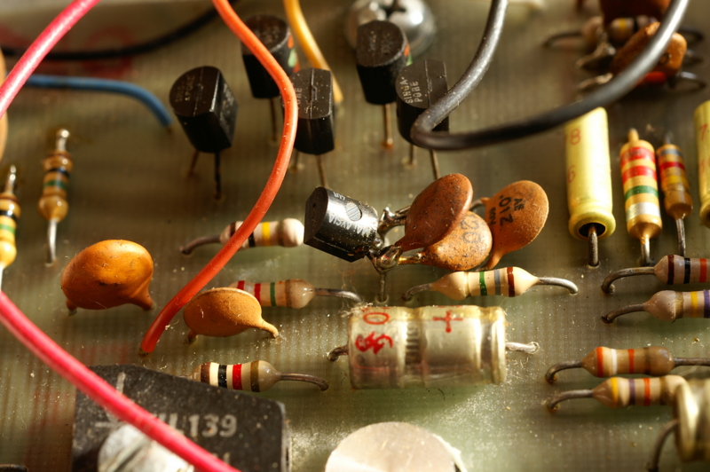

I have a bunch of RM gutshots in my gallery at Aron's site.
http://www.aronnelson.com/gallery/v/TCo ... r-Gutshots

Dunlop gut shots here. Judge for yourself whether the pot wire is in the wrong place on the PCB. It does appear to have the drive pot on the other side of the cap from the expected position, perhaps that's what he meant. Also looks like Q1 is backwards, like the old schems.

Recently I was looking for the gut shots of Roger Mayer Octavia on the web and what I found was that there are at least two main types of PCBs. You already know the one which is popular. But below you got pics of the other one that seems more interesting:
I don't know much about electronics but for me there are at least 9 transistors and a chip on the pics above. Is this a fake or maybe in 1970's the guts of RM Octavia were different?

(I'm guessing, but) maybe that was for the optical switching that was apparently in some (IIRC).
