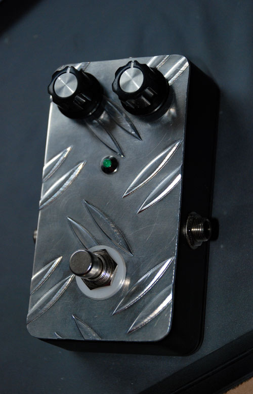

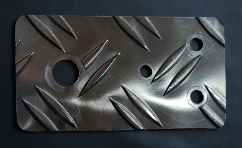

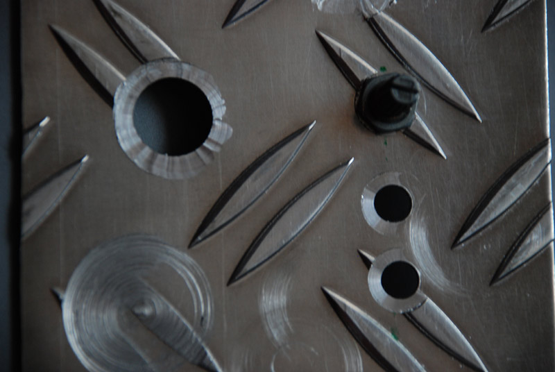

- new_anuzzerone
Just finished...
The tools arrived (I found them on evilbay, paid about $20 for 2 of them).
I tried to re-house my Red Llama clone, I think it looks great - now the parts for the Dr.Boogey have been ordered.
Take a look at the pics. The first shows, what happens, if the diamond plate is not totally secured and fixed in position. You got to work very slowly (I actually used some oil to drill and set the drill to a minimum of speed).
The other pics show the 1590B enclosure, the diamond plate finished and the whole pedal, re-wired.
The plate on top is secured by the screws of the fs and the pots
What do you think?

Here we go:
I´d like to introduce to you my
"red-llama-clone-rectifier-type-of-thing-whatever"
The "scratches" are not made by the actual counterbore, but by some sanding-stone, I tried before.
as you can see, you´ll get a smooth plate, to install the pots with no hassle
the assembled pedal
