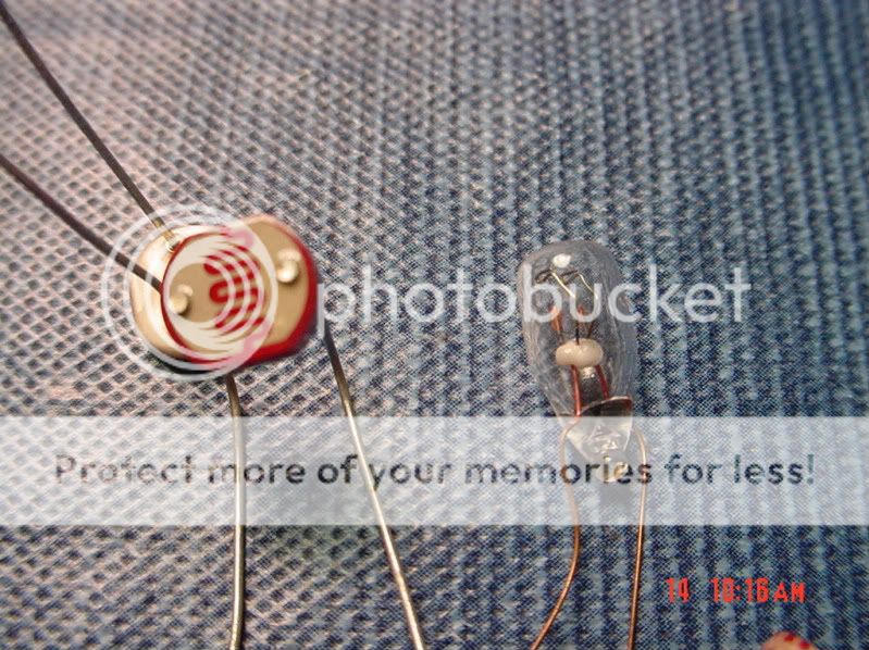

That's what I'm using in my clone. I've got signal and the LDR's respond to my hand over them. But, no bulb action. I have a bunch of different bulbs though, so hopefully one of them will work. I think I put an 18v bulb in, so I might try a 14v one instead. It actually does light up, but very faintly and it's not oscillating.

what wavelength at the LDRs most sensitive to?

outtahear wrote:No parts numbers, but here's a set O' LDRs and incandescent lamp courtesy of Uncle Bob hisself.
Same ones he used on his vibes, got 'em 12 or so years ago.
Has anyone seen a bulb like this one somewhere? Looks to be very close to the one in the old originals. Would be great to find something like that one in 28V, 40ma, or very close to it. (Probably not much of a difference other bulbs, but still would be cool).

Hi guys, i have a suggestion for Madbean in case he still didn't get his vibe to work, i had the same problem with the oscillator in my univibe clone, and i resolved putting 2 very high gain npn on q11 and q12, if i remember right bc549 (common EU NPN).
I just started collecting parts for my vibe build, and somehow that bulb reminded me of something...
back in the days my grand dad used very similar looking lamps for his rc ship models.
Something like that:
http://www.voelkner.de/products/17501/S ... -20ma.html

I just bought that mini 12v 40ma lamp and it looks very very similar to the mojo vibe bulb.

here are links to LDR/Bulb:
http://www.banzaimusic.com/Bulb-12V-20mA.html
Single LDR:
http://www.banzaimusic.com/Univibe-Phot ... -500k.html
And a matched set:
http://www.banzaimusic.com/Univibe-Upgrade-Kit.html
i used the 4 single LDR's in the other univibe clone with the 3 voice settings: Roger Mayer, Shin-Ei and forgot what the other was.
Dont know if the matchin is really needed, but i can think that you may get better pleasures. At the time id built my Vibe there
was no set avaiable. Sounds great also...
