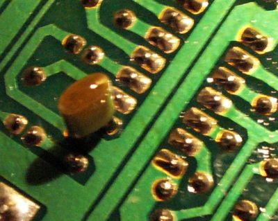

The schematic is wrong:
There is a 100 Ohm resistor (R 31) between pin 8 of the LM1894 and the connection C12/CX. CX is numbered C27. :wink:
Posts: 4156
Has thanked: 218 times
Been thanked: 857 times
analogguru wrote:The schematic is wrong:
I am really sorry AG but this is not the case.
Between 8 and 9 is only a C and that's C12. CX is, as mentioned on the bottom of the schem, mounted on the copper side. Therefore it does not have a component number.
:hmmm: :hmmm: :hmmm:
So what does this mean ? That it is really not the case, or that Dirk is a beta-tester ?
I am really sorry, but..... :wink:

The datasheet mentions this 100R resistor as only required in FM applications. Different revisions of the PCB then?

It means I need:
a) to remove R36. That's definitely an error.
b) I need to take a photo of exactly the same location to prove both AG and me are correct and are, apparently, dealing with different PCB versions.
Posts: 4156
Lousy light for photo's...
Board:
PCB-NB-0101A
I believe that.....
But yours is older - chip: 8724
mine - chip: 8748

analogguru wrote:I believe that.....
;) I assume this is the most spontanious way of AG saying we're both right :mrgreen:
Got that out of the way.
Do the pics you posted earlier todal come from larger images that 1) show the PCB version and 2) show that the connection to D3 was screwed (in the PCB layout) and fixed with a piece of wire??
No.... because I am sure when I argue that you will have controlled it before you answer :mrgreen:
Dirk_Hendrik wrote: Do the pics you posted earlier todal come from larger images.....
No, they were taken extra for you. To do that I had to move away more than 100 pedals before. And than I put it back and the other pedals too.
DirkHendrik wrote:
.... that 1) show the PCB version and 2) show that the connection to D3 was screwed (in the PCB layout) and fixed with a piece of wire??
Dirk costs worthful time of my life. To answer this question I had to move away the pedals again, take the pictures below and put everything back..... But what I don´t do all for Dirk...
enjoy the guts of a virgin NB10 (never connected to a battery).

Which shows yours is indeed a later PCB revision and is younger. That in turn means mine is older and therefore must sound much better. :mrgreen:
Thanks AG! :thumbsup
No, yours is a prototype ("A" like alpha) and you are a beta-tester :mrgreen:
You can recognize this on the box - prototypes never come with a box. Do you have one ? :mrgreen: :mrgreen:
above added a picture of the outside.

IC3 must be LM1894, not LM1849, as stated in the schem, no?
