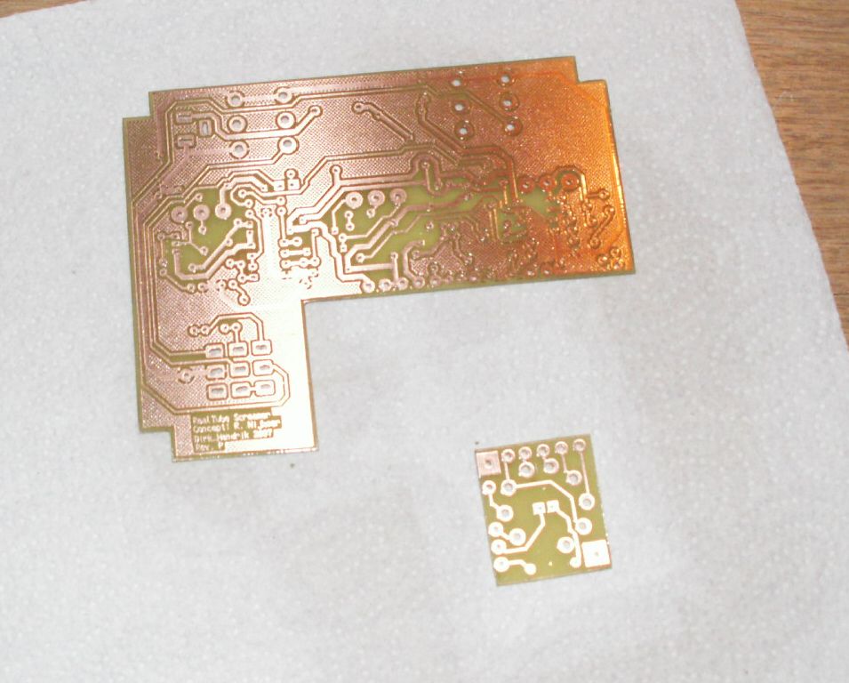

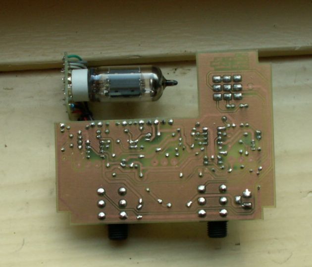

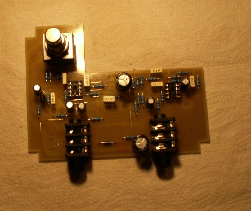

Posted here somewhere else already a while ago but belongs here somewhat. Tubescreamer with a starved plate distortion "engine"
http://www.dirk-hendrik.com/temp/rn_tubedrive.pdf[/url]
all made to fit a 1590BB case smoothly.
And some pics:

As far as I can see it is based on jack orman's tubedriver plus a ts tone control and an output buffer...
If you want to have an idea of the sound you can find some samples of the JO tubedriver here http://www.diyitalia.it/index.php?optio ... 5&catid=53 (notice that the 100n cap before the tube has been changed with a 18n one because it sounded buzzy)
BTW Great PCB work :wink:

The rough schematic is not mine. It came through another project but I decided that one had too muck offboard wiring.
The Orman tubedriver comes straight from the BK butler tubesdriver.

You can call me over fifty, but eh.. I can't seem to find the power supply rating.. my guess it's 12-15V DC, or is it fine on nine ?
Posts: 4156
Has thanked: 218 times
Been thanked: 857 times
12 max
