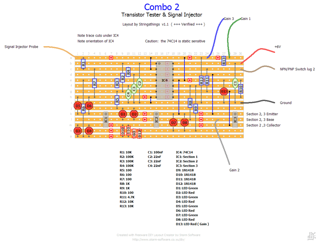

technically not a stompox ... but a nice circuit to have around ...
http://talkingelectronics.com/html/Combo-2.html
and a verified layout for the DIY-project-builder in everyone :P
