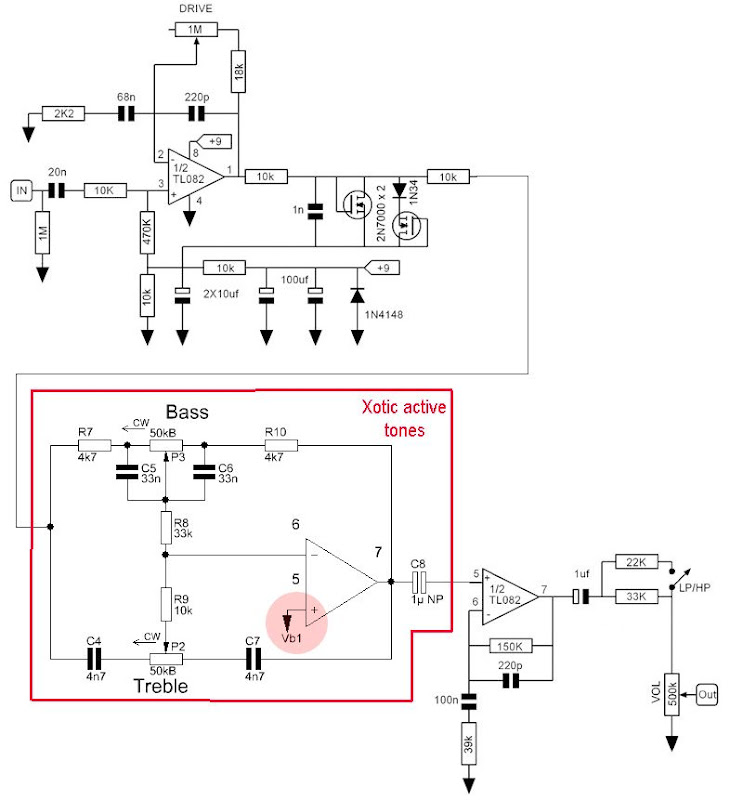

I'm a big fun of the OCD, I made my clone and I really like it. I want to make another one but this time I would like to include active tone controls, like those used in xotic pedal.
Question:
1.- Are those tone control effective?
2.- What do you think the place in the circuit I put this controls?
3.- In the below circuit Vb1 is about 4V in the xotic circuit, why they reduce this voltage? What are the consequences of use 9V here?
Alfredo

you need a decoupling cap on the input of the active tone stack, and you need to add a Vref to the output buffer accordingly, since its input will no longer be at ~Vref

LPantique wrote:I'm a big fun of the OCD, I made my clone and I really like it. I want to make another one but this time I would like to include active tone controls, like those used in xotic pedal.
Question:
Not very. They'll adjust the tone a bit, but there are better ways of doing it.
LPantique wrote:2.- What do you think the place in the circuit I put this controls?/quote]
that's the best place
LPantique wrote:3.- In the below circuit Vb1 is about 4V in the xotic circuit, why they reduce this voltage? What are the consequences of use 9V here?
Vb is a "bias" voltage. For the op-amps to work, they have to be biased to (roughly) half the supply voltage. The + (non-inverting) and - (inverting) inputs have to be at roughly 50% of the supply voltage. The output will follow the inputs. It would probably be useful for you to read some basic op-amp theory!

Hides-His-Eyes wrote:you need a decoupling cap on the input of the active tone stack
Please suggest how to implement the decoupling cap, maybe like this?
Hides-His-Eyes wrote:, and you need to add a Vref to the output buffer accordingly, since its input will no longer be at ~Vref
To solve this, do you think by changing the first half of the tl082 to a single oamp and then merge the two next oamp in a dual oamp may work?. Maybe use a quad oamp?

Post by Hides-His-Eyes »
Coupling cap should go in series after the 10k resistor I think, 100n is a sensible value.
I'd use a dual and a single if you're doing it on vero or perf, and a quad op-amp if you're designing your own PCB.
Oh and no, the vref has nothing to do with the op-amp arrangement; there's a vref on th schematic at the bottom of the 470k resistor on the input to the first op-amp you can use though. Mirror that arrangement (so send another 470k from the same point to the non inverting input)
Also, this will leave the output inverted with respect to the input. Dunno why whoever designed that tonestack would do that. Not the end of the world, but considered bad practice.

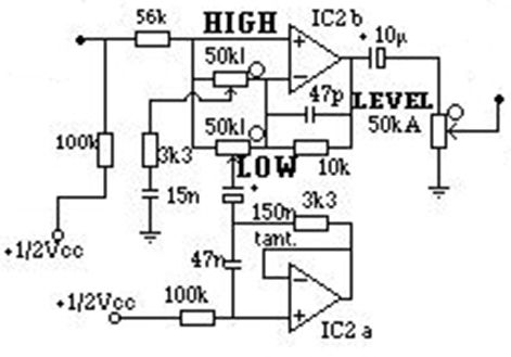

I found the schematics for Boss hyperfuzz, which also has a active eq. From what I just learned, the EQ here is a non inverting circuit. Below is the extract of the EQ.
Also, people say this is an amazing pedal. So I think I going to change the EQ to this circuit. Suggestions?

I think mictester is a fan of the 2 knob 'James' (baxandall?) tone control, which allows both mid boost and mid cut with only two knobs. However I still think the big muff tone control is pretty great, especially with a mid control, if a large mid cut or boost is required. It's almost worth building on pot versions of a few popular tonestacks (with key components in sockets) for testing purposes, if you're going to do a lot of overdrive/dist design.
