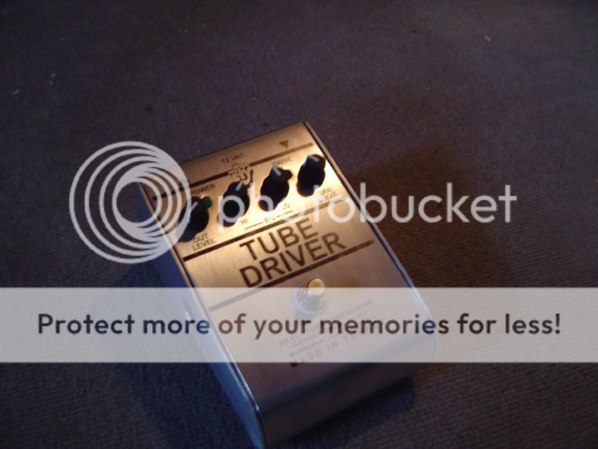

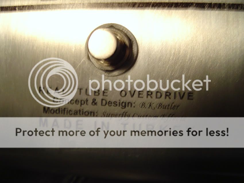

Finaly I finish the ,,modificated'' chandler enlose.
I use a opa2134 opamp and polyester capacitors (wima-siemens-phillips), it effects the sound of the pedal very much, by the way, i put no transformator inside the pedal, i use a 12v ac wall warrend adaptor to power up the pedal, maybe its better i think, a transformator inside the pedal will make magnetic fields and surely this will effect the sound quality. (The enclose is completely handmade without using a machine).
Thanks to Bajaman
Here are some pictures:

abalci72 wrote:by the way, i put no transformator inside the pedal, i use a 12v ac wall warrend adaptor to power up the pedal, maybe its better i think, a transformator inside the pedal will make magnetic fields and surely this will effect the sound quality
Not that much influence with a toroidal tranformer (but I will go with a separate power supply as you did) :)
abalci72 wrote:(The enclose is completely handmade without using a machine)
Lovelyyyy! You did an amazing handcrafting job here!! It's really brilliant, I wish I was as gifted as you are with "jewelery"...
