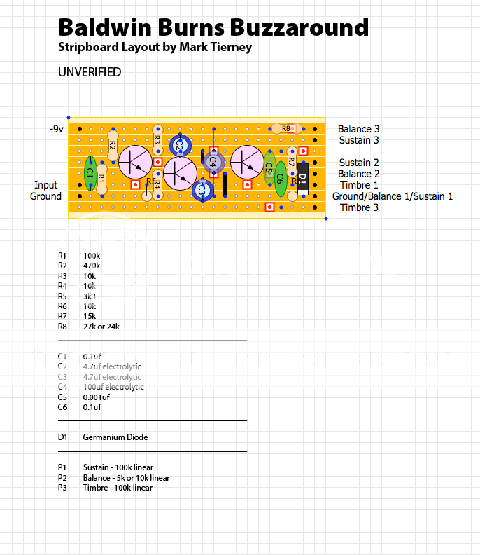

by tatter
Here's a compact stripboard layout. This is my first attempt at doing my own layouts so constructive criticism welcomed! Based on Andy Carrell's schematic. I've built this using 3 x Mullard OC74 and it sounds great but until someone else has a go i'll say it's unverified

by RnFR
if you built it, and it works, i'd say it's verified. don't sell yourself short! :wink:
nice layout. since torchy pulled his, we'll need some people to pick up the slack.
