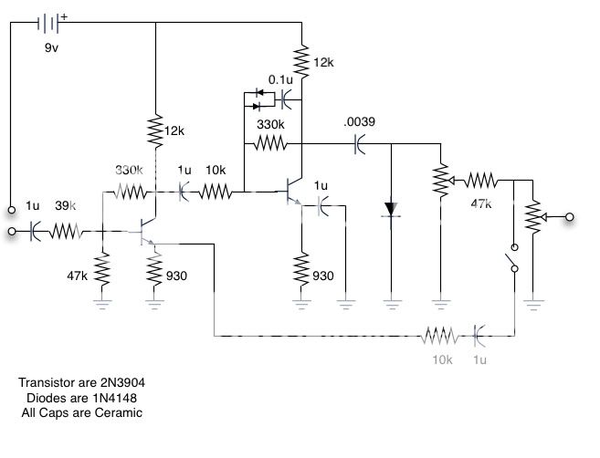

I modified a Maestro FZ-1B to have more muff like gain stages but I'm wondering if there are any foreseeable issues? This is my first design, I've already test built it and it seemed fine (and sounded very fun) but I don't know a lot about electronics. I wired it up with a 3PDT and an LED. Here's what I came up with, please criticize.
EDIT: Pots are 100k log

hmmm, looks good, but im kinda confused why you'd need 2 volume(?) controls. maybe you could put another resistor (10K perhaps) on lug 1 of the pot before the 47K and feedback switch.
how does it sound on breadboard?

The first pot is a blend pot to give you a mixed fuzz/clean sound. The switch disables it.
It sounds pretty decent. Smooth and medium gain.
I'll post a clip tomorrow. I'm a newb and I'm worried about my diy pedals damaging other pedals due to a dumb oversight on my part. Am I just being paranoid?

yes you are
unless you use unusual power sources, there aren't much risks

I can't see any real way that you could damage any of your pedals, unless you fed an unusually large signal into them, or maybe used too high a voltage to power them... :)
By the way, your design looks fine to me..... :)

I'd use a non-polarized for the 100n cap if I were you.

He just used the wrong symbol:
All Caps are Ceramic

Good, so I'm just being paranoid. Here's what it sounds like. I've removed the blend to try a fuzz control instead. Not sure which I prefer.
