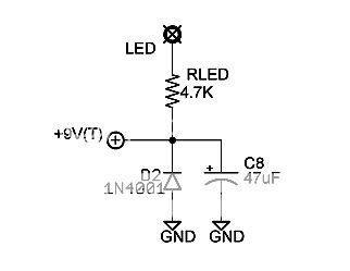

what's the deal with the in4001/47mf cap to the led? is that for the indicator led to flash or something? :scratch:
i haven't boxed it up yet, figured i better ask, cuz i don't get it!! :shock:
does it matter where i take the b+ from? is it necessary, or can i just hook the led up the way i normally would to the 3pdt switch?

Don't know which layout you are working from, but sounds like the diode/cap is for polarity protection/filtering. Yeah, I would hook up the LED as you normally do..... should be good to go!

ah.... if it's the Eagle files layout, you would just connect the positive leg of the LED to the LED pad and run the negative leg to your foot switch. The resistor marked "RLED" would be 4.7k or whatever you normally use for your LED limiter resistor.

thanks greenskull, i appreciate it. i'm working from the schem in the zip file earlier in the thread, i built the vero layout. but it doesn't show the in4001/47mf part.
here's a snip:
here's the whole schem...can you or someone please tell me where this is supposed to hook up? it says to t, but i don't see a t on the schem other than at ground...

The diode is for polarity protection and the big cap is to filter the power. I don't usually bother with polarity protection, and I usually hook a 100u electro directly across the power jack, so I left them off that vero layout. I have since updated the layout to include them, and I'll upload it when I get home tonight.

ok, gotcha bro, thanks!
i'll add the cap right across the power jack,

Version 3 - Now with on-board polarity diode + filter cap:
