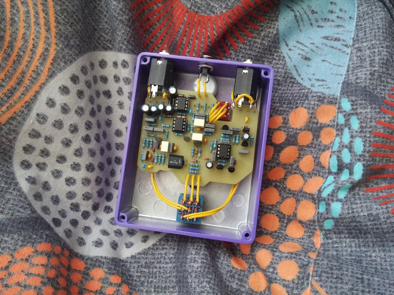

Pokfor
Posts: 10
Joined: 08 Aug 2014, 06:04
my favorite amplifier: Rock Seasons
Location: Russia
Been thanked: 14 times
Post by Pokfor »
My job.
PCB File
Diamond Bass Comp.zip
(80.41 KiB) Downloaded 249 times
The case was used from here https://www.taydaelectronics.com/hardwa ... osure.html
Signal capacitors WIMA FKP2 and MP4
There are some deviations from the scheme published here. R6 (6k8 according to the scheme) used 100k, because the green LED was much brighter than red and the operation indication was not correct. C26 and R31 are interchanged. There are still large deviations in the supply chain. All this can be seen on the board file.
Моя работа на русскоязычном форуме вот тут http://guitar-gear.ru/forum/topic/5975- ... ompressor/
