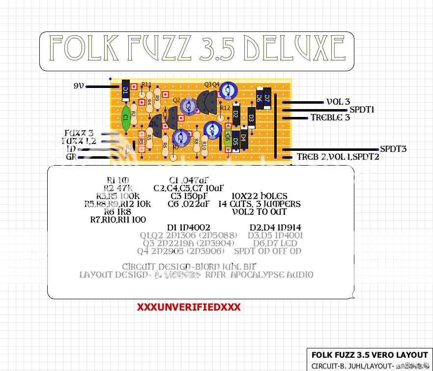

i made this layout a while back, thought i would post it here since ol' torcho pulled his. it's yet unverified, but i have checked it and believe it to be correct. if someone wants to double check, that would of course be great. and as always, if you build it, let me know.
cheers.
db72
Posts: 29
Joined: 20 Feb 2008, 22:52
Post by db72 »
Anyone do a vero of the Deluxe version? I heard it has an extra set of diodes and LEDs you can switch in.
here you go! i found a missing trace cut in the other layout as well. if you build it, let me know so i can mark the layout verified.

The schem in the link has just two pots. I've seen pictures of pedals with three, is that the delux version? Anyone got a schem in that case? Or could somone point out the differences?
Cheers/Ben
I'm certain the 3-control version is the "3.5%" one. I believe the only major difference is the addition of a tone control.

Here's the one that was used with the boards designed by J Frommel & NOC3 as approved by Bjorn.
The boards a labeled "Folk Fuzz Dlx 3.5%".
Hope this helps.
