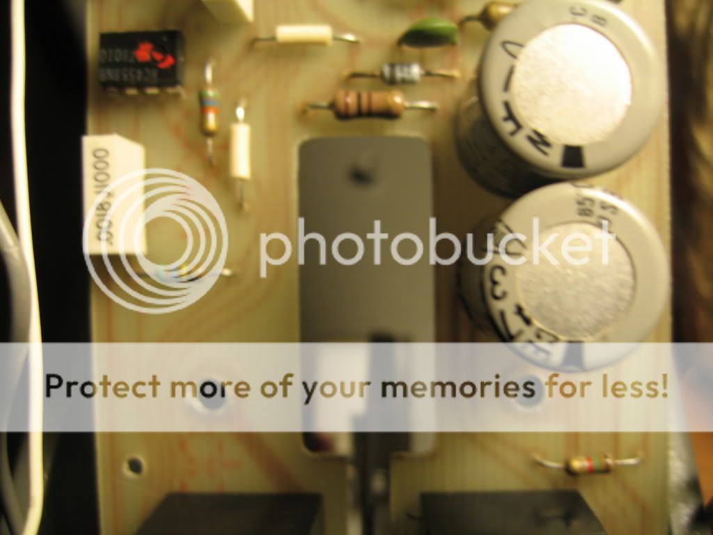

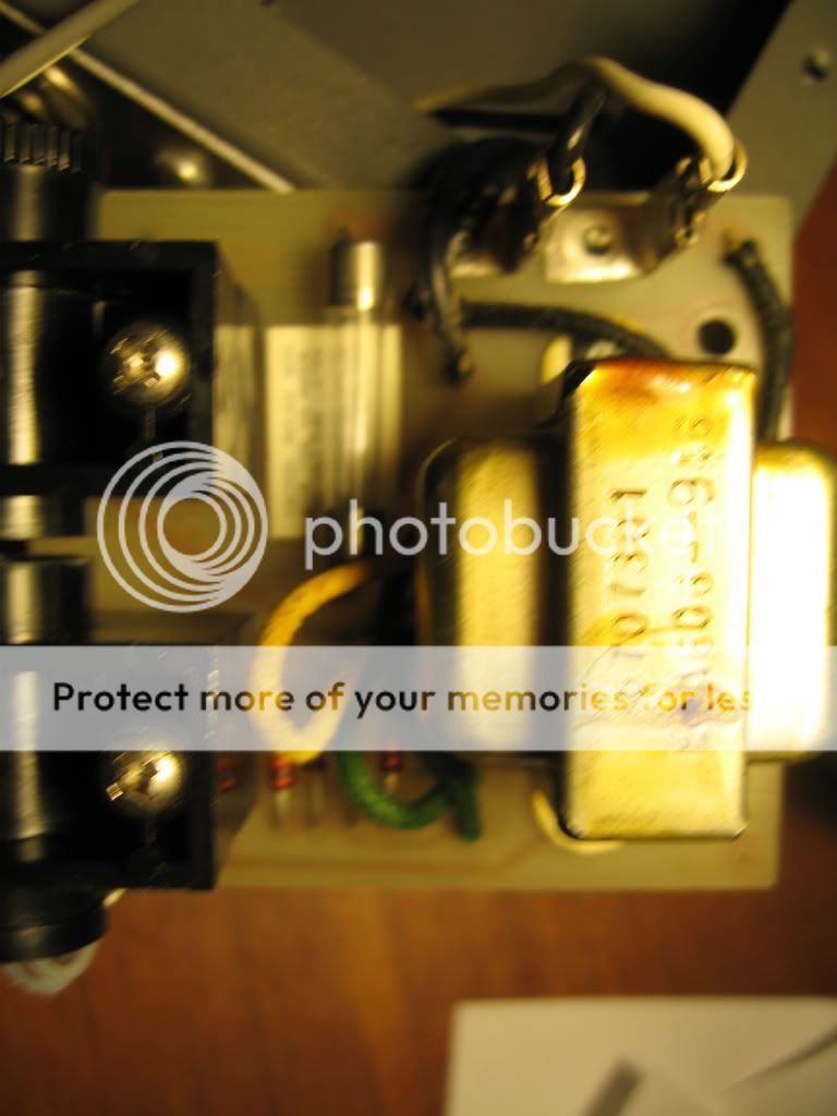

I'd love to see the schematic for this as I have one of these
that needs to be repaired (functionally works but LED logic is a little
messed up)
Jeff
brightboy wrote:I'd love to see the schematic for this as I have one of these
messed up)
Jeff
Hmmm.... this are now from the 4th pedal the guts I have seen....
bud sadly I never have seen a schematic.

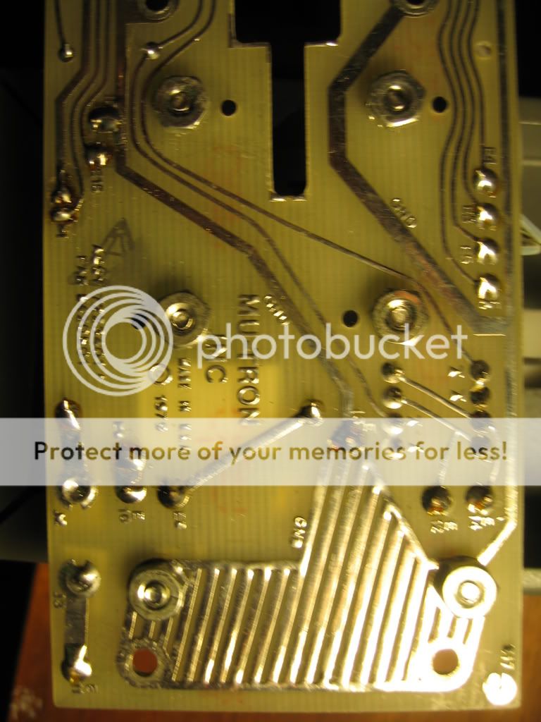

I also never have seen the track/solder-side of the pcb. If I would, I could have drawn a schematic from this pedal. And I could show this schematic to somebody else who would need it to repair his pedal. :wink:

Brightboy...take some pictures of your unit (track side, front side, wiring connections) and AG (or one of us forum members) can trace it out for you, so that you'll have the schemo.

when pedal is moved :arrow: there is more or less light on PC2(ldr) :arrow: D1 provide more or less light(led is near PC1a and PC1b)............Am I right?
...those links are not functional,so please post some pictures.

please if somebody have nicer pictures of PCB,and connections DO NOT POSTTHEM!!!

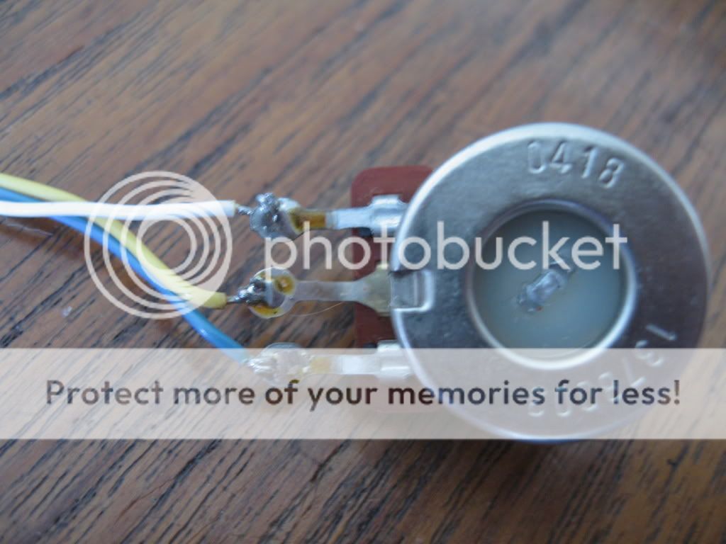

What is adjusted by the threadle? Is it a pedal like a Morley (threadle moves a cloak for the lights) or does it adjust a pot?

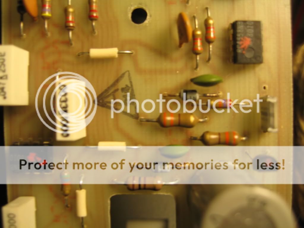

Post by Dr. Molly »
Hi
Not the sharpest ones in the world but ........
/H

From Ampage:
"The LED portion is one one side of the blade mounted on the pedal and the other side is a phototransistor."

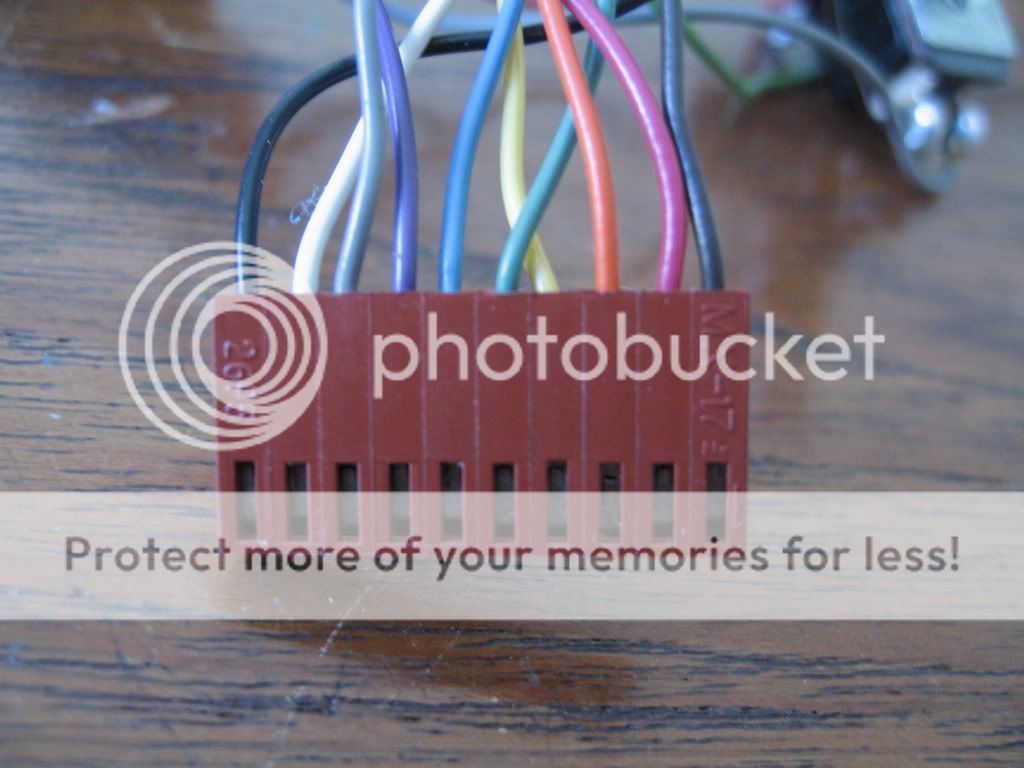

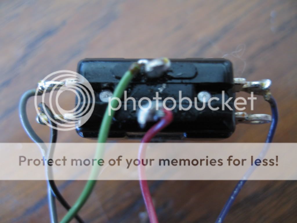

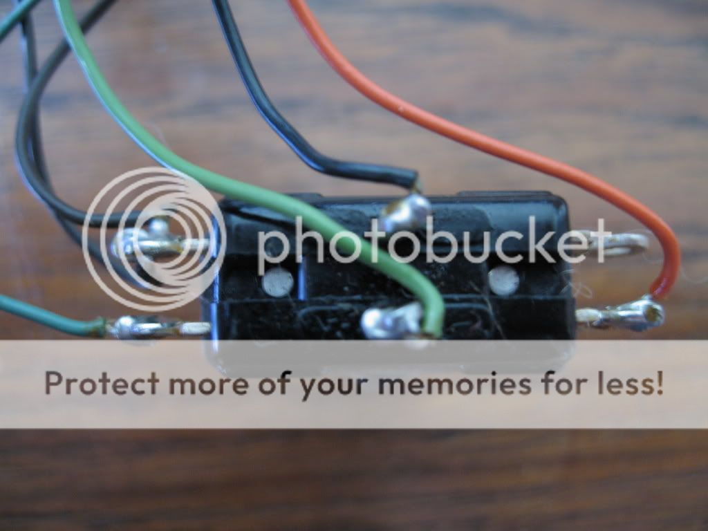

Dr. Molly please could you take fiew more pictures ...wires,pot,jacks....whole enclosure?

I traced schematic from posted photos...and it is little different from posted schem.....
trimpots are wired differently(two resistors 39K added)
vol opamp has cap from pin6 to pin 7.......
resistor 100R in power section (should be 220 R)
output cap looks like polarized(on schem is 10mF NP.)
.....other is the same ...wah is same as on posted schem. :thumbsup
from what period is your pedal Dr. Molly?
Dr. Molly
Posts: 46
Joined: 08 Nov 2007, 17:31
Location: Sweden
Post by Dr. Molly »
Hi
Mine was made in 1980 according to the pot. I'll post some more photos tomorrow.
