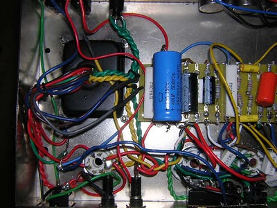

My bad. One of the reasons I ask is, I have a Judybox chassis and a 112 cab for it to go in, It is pretty much all wired up except for one minor detail. There is no MAIN board! I have to figure out what to do with it. I'm thinking of an eyelet board or similar, but not sure which one would work the best.

I will finish the 5E3 kit here soon, but I still need to do something with the Judybox. The chassis has 3 tone controls on both channels,but I can't seem to find a schematic to see what it is based on..

CharlyG wrote:I will finish the 5E3 kit here soon, but I still need to do something with the Judybox. The chassis has 3 tone controls on both channels,but I can't seem to find a schematic to see what it is based on..
What else does it have? You're choices are likely to be narrowed by the iron and sockets.

It is called a Judybox Revival 28 watt 6L6 amp with tube rectifier and 3 12AX7 sockets. No numbers on the transformers anywhere that I can see. The board was cut out so all of the wires are still in place. I hadn't seen the model before so I will go Google it now.

Post by CharlyG »
I found a picture, still snooping for schematic. I also found out there are a few boards floating around after the close of the shop. I have a request in to see if I can obtain one!
