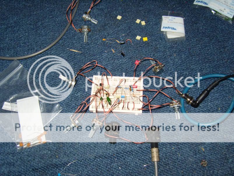

2) The Breadboard[/b]
Here's the little sucker on the breadboard, testing was completed and confirmed that the little bugger made one hell of a racket - mission accomplished! (Note the cigarette burns on the carpet! Ooops!)

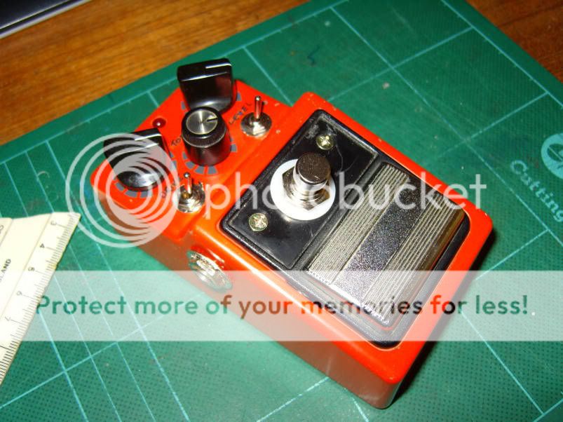

3) The Enclosure[/b]
I decided that "L'Overdrive de la Revolution Deux" needed a special enclosure (Read as; I was skint and didn't want to spend any cash buying a new hammond case!) I took the case from an old bust Ibanez phaser and modified it to my tastes.

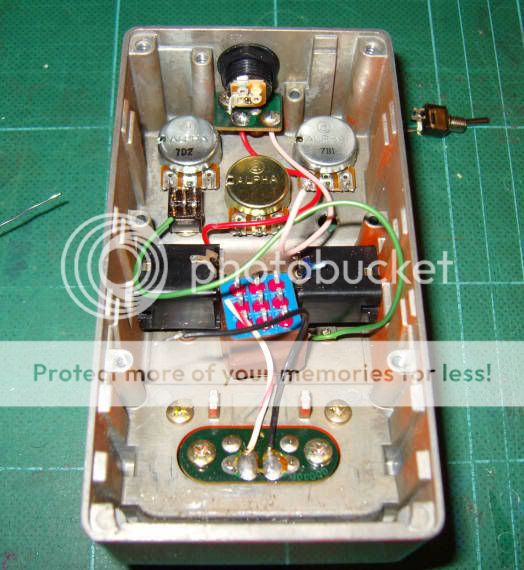

4) The Enclosure Continued[/b]
A quick picture of the innards in place, you can see the squeeze I got into, having to slot that 3PDT in there was almost an error. The original footswitch will be used as a little "bonus feature" 8) Note the tone bypass switch and the voice switch (which is lying at the side of the enclosure!)

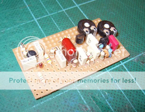

5) The Circuit[/b]
I decided, for the extra mojo, to build the circuit point-to-point on perfboard. Here it is, layout completed and ready for the wires to go on! Note the two trim pots used for biasing the FET's to the correct voltage - very important!

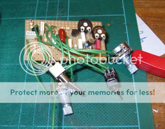

6) Wiring and Test[/b]
After I wired all the controls in place I fired the circuit up for debugging, as usual there was no errors at all :wink: All of the wiring was kept as short and neat as I could be arsed with!
