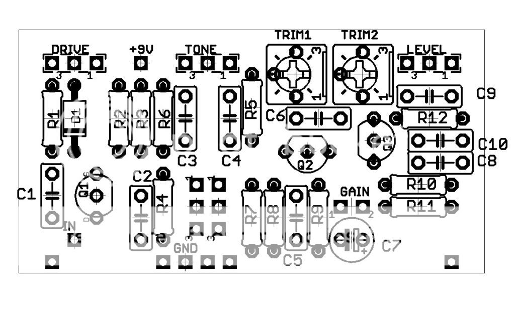

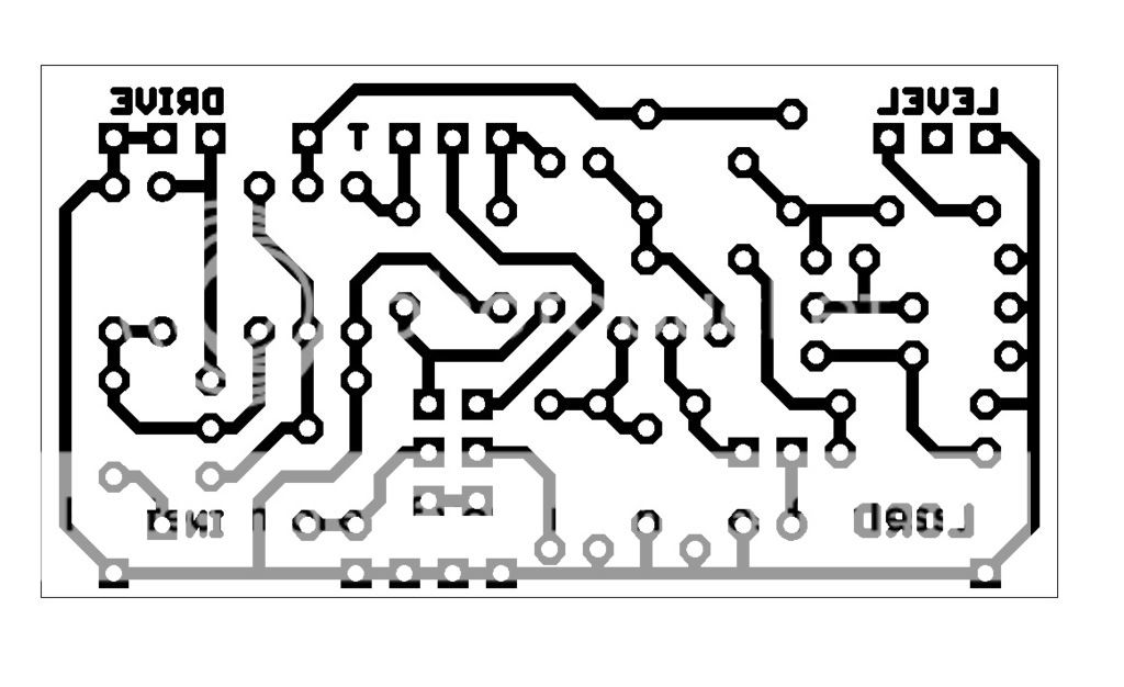

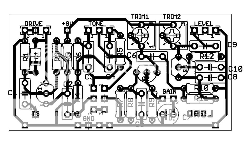

Hi there marshmellow. Thanks for that. I keep getting an error when I try to open up the two layouts and the PCB at the moment.
Also one other thing, in my build I used the "Alt Tonestack" instead of the regular tonestack... Both sound good though.
Thanks again marsh!

im afraid i might mess up trying to build it using schematics..
can someone kindly do a perf or vero layout for me?
You could just use the PCB layout. Put it on unclad perf and follow the traces in the PCB layout with the leads from the components - just mimic the drawings of the traces with wires. That's how I started building perf. You could even print out a copy of the PCB and tape it to the perfboard to use as a template - alot of people have done it that way. When I started - I redrew the design on perf with a sharpie marker and followed it like that.

Yes, but if you want to use the "Alt Tonestack" you will have to alter the layout very slightly.

Briggs, I finally had the time to update the schematic... sorry for the delay.
Apart from that, the other tonestack could also be fitted in the pcb. With upstanding resistors and connecting the RC-combo to ground in between with wires. Actually I thought about the possibility to use both on the pcb, but then I would have to use a jumper for the original one and I don't really like that so much :wink:.
