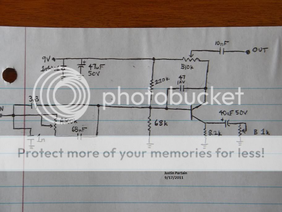

Hey, finally got this thing back out. This schematic has been double checked using continuity tests by me, whether that's verified by the standards here or not, I'm not sure :)
EDIT: And the little blue cap is labelled like I labelled it in the schematic (47 over 1KV)

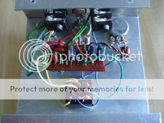

fwiw , my viper build [ only had two of the clear knobs ]

per traced schem jwpartain1, Heat Pot 3-2 linked & 1to gnd. PCB & Vero show Heat 1-2 linked & 3 to gnd. Which is correct??? If schematic is correct are layouts off???
coldcraft
Posts: 725
Joined: 11 Jul 2009, 01:00
Has thanked: 38 times
Been thanked: 84 times
Post by coldcraft »
ezs wrote:per traced schem jwpartain1, Heat Pot 3-2 linked & 1to gnd. PCB & Vero show Heat 1-2 linked & 3 to gnd. Which is correct??? If schematic is correct are layouts off???
they are equivalent because that pot is linear.
