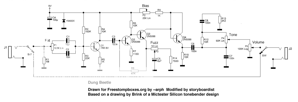

So would this schematic be correct?

No, if I get it right:
John Lyons wrote:Q3 emitter goes to .1 then to the high side of the tone pot.
Split off the same .1 is 10k to the low side of the pot and
a .1 to 2k2 to ground. (Low pass only, shelved at that)

Yeah, that part confused me. But his description of the tone circuit made me think he may have meant Q4? :?
roseblood11 wrote:No, if I get it right:

storyboardist wrote:Yeah, that part confused me. But his description of the tone circuit made me think he may have meant Q4? :?
Yes that's the way I interpreted it too. But John said the 100n goes to the high side and then a 10K down to the low side which to me sounds like the 100n from the emitter goes to the 10K/100n junction rather than as it is in the updated schematic going to the low side of the pot.

Ah, so like this:

storyboardist wrote:Ah, so like this:
[ Image ]
Yes that looks like the way John described it, or at least that's how I understood it.
