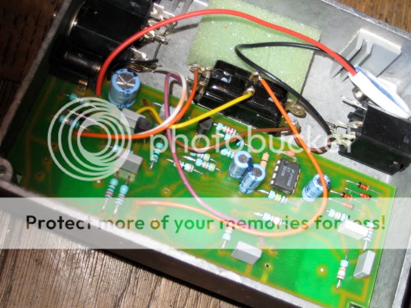

vhollund
Posts: 44
Joined: 09 Jan 2008, 00:20
Post by vhollund »
I finally got a camera that can take a high resolution photo
so here it is
Let me hear what you think
Could there be improvments changing then chip maybe
or is it possible to make a true bypass ?
Vaughn Hollund
Ok, here is the first time in stompbox history an authentic
Roger Mayer - Voodoo-1 schematic
enjoy,
Here:
viewtopic.php?f=7&t=3160&p=34589#p34589
an authentic schematic of the RM Voodoo-1 can be found.
If you control the cap values - especially of C9 and C10 - and let me know them I could finish the schematic.
You can have a look at the:
Roger Mayer - Mongoose schematic
and the:
Roger Mayer - Spitfire schematic
and compare the three to see, what Roger Mayer does to sell you basically the same circuit three times. Use it as an inspiration for modding your Voodoo-1.
I don´t know what you expect from true bypass -sometimes it is even better when the signal is buffered.
The simplest way to bypass the buffer is to desolder the white wire from the output jacks and solder the yellow one there - even when it is then not "true" bypass.
For real true bypass you can wire it as shown in the mongoose or spitfire schematics, if you don´t need the LED.
If you want to keep the LED you would need another footswitch - a 3PDT.
