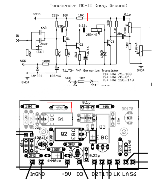

A little while ago I knew nothing about Fuzz designs, today I know little bit more.
I´ve understood that a PNP Fuzz "fixed up for negative ground" means problems, but I did not know this when I ordered a Tonebender Mk-lll kit of such a kind.
Here´s the schematic

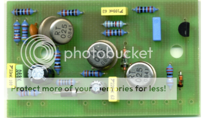

I built the pedal today, and it does work and sound quite OK, but something MUST be wrong...
I can't bias it any lower than a little below 6V no matter what I do.
I´m using a 22k trimpot, instead of the 18k resistor, but even when I turn it down to "min" the bias remains about 6V... (I´ve tried fixed resistor but with the same results)

It's possible that the reason why you're getting those voltage readings is that you're measuring them with respect to the negative grounding system, rather than with respect to Q3's Emitter, if you convert the circuit back to a Positive Ground, you may find that most of the problems will be cured, particularly the oscillation problem, I've read stories where some people built a PNP Germanium Transistor Fuzz Face, and had problems with the circuit "Motor-Boating" (oscillating at a low-frequency) at high Fuzz settings... :hmmm:

It's pretty easy to do, have a look at the schematic you posted, see where Q3 has it's emitter (the terminal with the little arrow) connected to?, well that part of the circuit becomes the positive ground system.... :thumbsup
And see all the points in the circuit that have the ground symbol on them?, well they all get connected to the battery's negative terminal.... :thumbsup
This is assuming that all your Germanium Transistors are PNP types... :thumbsup
Also note that the ground terminal of the 100kA Volume pot gets connected to the positive ground system.... :thumbsup

Those voltages look normal, with the exception that most of us are used to seeing them the other way around. Oscillation/hissing/whining at max gain is a very common malady of fuzz circuits. The hum may just be ambient hum being amplified a lot.
The peculiar problems that can only be fixed by switching back to pos. ground are RARE.
The issues you described seem more in line with high gain circuits in general. I would not worry about the limited bias range. For the other problems try limiting the gain and/or bandwidth (this is a very general purpose approach to your problem and it applies to many other similar problems as well).

Replacing Q1's 47k resistor with a trimpot won't really affect the biasing of Q3, since Q3 is isolated from Q1 and Q2 by the coupling capacitor (0.22uF) on Q1 and Q2's collectors, but it will allow you to tweak the biasing of Q1 and Q2, I think I remember building this circuit last year and with the stock resistor values, I had Q3 biasing-up with about 4.5V on it's collector, what you could try doing is see if changing the value of the 10k resistor that's between the 18k resistor and the negative supply (the one just above the 0.22uF coupling cap in the schematic you posted), say something like 22k, or 27k, and see if that gets Q3's collector sitting at 4.5V... :thumbsup

DrNomis wrote: what you could try doing is see if changing the value of the 10k resistor that's between the 18k resistor and the negative supply (the one just above the 0.22uF coupling cap in the schematic you posted), say something like 22k, or 27k, and see if that gets Q3's collector sitting at 4.5V... :thumbsup
Would that resistor on the schematic be the one marked in red on the layout?
I´ve noticed that if I use 18k as resistor on Q3 the motorboating goes away BUT:
- The pedal gets quite sputtery and grainy
- There´s a huge volume drop
- The bias on Q3 now is about 9v!!!!!????....
Seems like 18k is needed on Q3 in order to get rid of the motorboating.
Do you think that adjusting this 10k resistor - to about 22k-27k - will make it possible to get Q3´s bias down to about 4,5v without these strange behaviours (grainy/sputtery tone/volume drop) of the circuit?
When I´m sure about which 10k resistor to tweak, I will of course give it a try :-)

I´ve been going over the soldering/component placement for hours trying to get this pedal right, but I can´t find any mistakes from my side.
With 18k on Q3´s collector the motorboating goes away BUT the sound is now "the sound of a misbiased fuzz" (sputtery, grainy, harsh...) and the collector of Q3 now reads almost 9v!!!???...
I did tweak the value of the 10k resistor that I marked in my previous post, and I found that by lowering it´s value the bias of Q3 goes down. The pedal now sounds much better BUT the motorboating (from 4 o'clock on the drive) comes back...
Every attempt at trying to bias Q3 by changing values on resistors seem to put the circuit of balance, creating this motorboating and hum...
Someone, on another forum, suggested that it´s the diode that biases Q3, and maybe it´s the diode that is bad?
Or maybe I got the wrong one?
Is it the 1N60 GE that is doing the bias of Q3?
I´m really frustrated by all this.
I´m quite experienced at soldering both pedals and amps - so I´m not a total newbie - but right now I can´t get this pedal to work and sound right.
I must chose between a pedal that does not hum or go into motorboating but that doesn´t sound very good, or a pedal that sounds great but has a lot of hum and where I can´t use the full range of the drive knob...

Yep, that's the resistor I was referring to, you could also try replacing it with a 20k trimpot and adjust it till you get Q3 biased right.... :thumbsup
That 10k resistor and the 18k resistor form a voltage divider which works with the tone control network.... :thumbsup
What the diode is doing, is acting as a Temperature-Stabilizer for Q3 as well as biasing it, if you look at the circuit of a Tonebender Mk1 or Zonk Machine, you'll notice that two of the three transistors have a resistor going from their Base to circuit ground, these resistors bias the transistor by diverting some of the transistor's inherent leakage current to circuit ground, the diode works in a similar way but because it's a Germanium diode it's characteristics are temperature sensitive too, so as Q3's characteristics change due to the ambient temperature, the diodes characteristic change opposes that of Q3, diverts more of Q3's leakage current to ground and stabilizes it.... :thumbsup

I did tweak that resistor, and it was a lower value that reduced the bias of Q3 BUT as soon as I get the bias down a bit the hum and motorboating starts...
With original values there no hum and no motorboating but the pedal IS misbiased which one can tell not only from the harsh, sputtery grainy tone, with that horrible decay of the notes, but also from the fact that Q3´s collector now is close to 9v!
Here are the voltage readings:
Q1
E= 7.51V
B= 7.39V
C= 5.60V
Q2
E= 7.62V
B= 7.51V
C= 5.62V
Q3
E= 8.99V
B= 8.89V
C= 8.76V
Compared to another build, by someone else that was kind enough to send me his readings of the same kit, the readings are quite close until we reach Q3´s collector:
Q1
E= 7.72V
B= 7.61V
C= 6.42V
Q2
E= 7.82V
B= 7.71V
C= 6.42V
Q3
E= 9.38V
B= 9.28V
C= 6.35V
I´ve started to think about the 1N60 diode as a cause of the problem (It does have SOMETHING to do with the voltage of Q3) and when checking the voltage of that one I get 9v on one side and 8,9v on the other.

Hmmmm...that indicates that there's about a .1V drop across the diode, normally the forward voltage-drop of a Germanium diode is about .3V so you should be seeing about 8.7V (9V-.3V=8.7V) on Q3's base, so this indicates that Q3 is being biased almost fully-off by the Ge diode, what you could try doing is try replacing the diode and see if Q3 biases-up normally, if not, I'd be suspecting Q3, I've done a re-draw of the schematic you posted for clarity, I scanned it into my computer so I can post it here for you:

Tonebender Mk 3 Redraw

A zillion thanks :D
I´havan´t got any diode right now so I´ll have to order some.
I´ll be back (if anyone ever doubted that :wink: )

Fixed!
I swapped out the diode and the Q3 transistor and the pedal now rocks big time :twisted:
