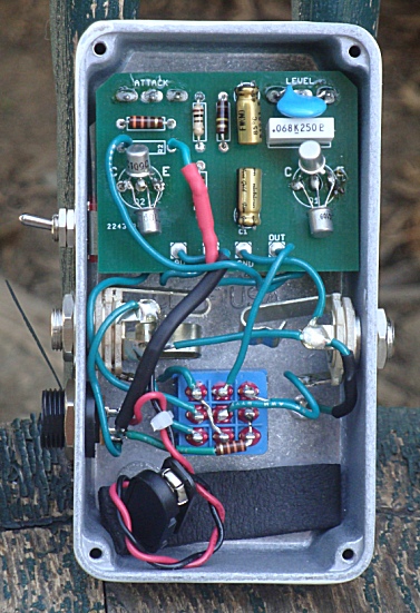

DrNomis
Posts: 6801
Joined: 16 Jul 2009, 04:56
Has thanked: 98 times
Been thanked: 274 times
Post by DrNomis »
You can also buy the Mojo Fuzz Face PCB kit from Pigeon FX, you get all the Mojo style vintage parts plus a Brown Paxolin Etched PCB in the kit, here's a pic of the insides of my Germanium Fuzz Face build using the Mojo Fuzz Face kit I bought recently, the only components you need are the transistors, pots, footswitch, sockets, battery clip & holder, knobs, and enclosure:
