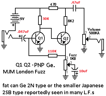

Another gut - It's a straight fuzz face, modified values. The input cap was 0.047uF and the output cap was 0.47uF, the big green bypass cap was 10uF. Pots = 1K and 500KA. Resistors, well you can see the colour codes on the two pictures... I thought I'd taken a picture of the trace side of the board but, oooooops, must have deleted that one! Still, a scheme is not to hard to work out from there 8)
it looks like the oposite to me but I don't have one in hand. Can you double check that?

I'm quite interested in the fuzz face circuit right now so I mapped this one out based on briggs photos and notes
thanks for the tip about the in/out cap possible switch! I will have to make note of that and do some testing in my build to see which is right
should be verifying this soon
any commentary welcome

Post by monkeyxx »
based on the values in red being slight variations from the original arbiter fuzz face (black are arbiter orig values left unchanged) I would guess that the .47 would be the input cap and the .047 the output, I will probably try that arrangement first. the arbiter and most fuzz face "clones" I've seen have the input cap being the much larger value of the two. I'll update the schematic if this proves to be true

This is probably the final schematic. I'm almost done building mine I'm just not in pedal mode right now.
MJM london fuzz (fuzz face) SCHEMATIC updated with transistor notes.gif (5.8 KiB) Viewed 2381 times
