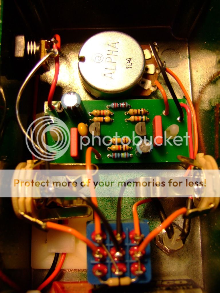

engineelite
Posts: 37
Joined: 11 Jun 2010, 22:47
Been thanked: 41 times
Post by engineelite »

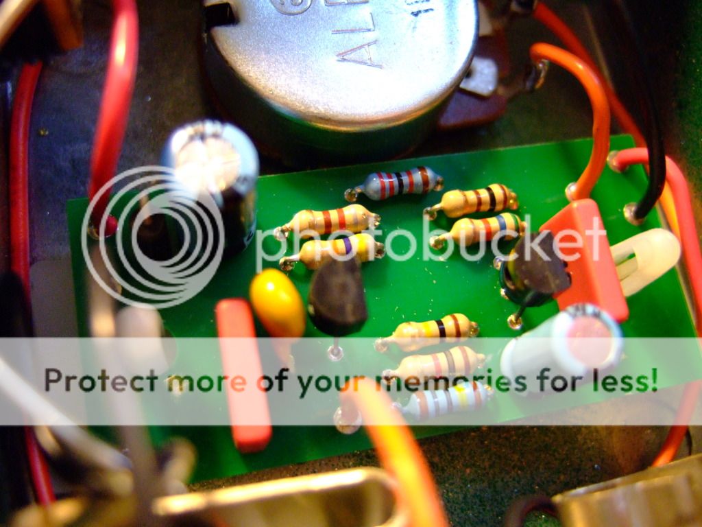

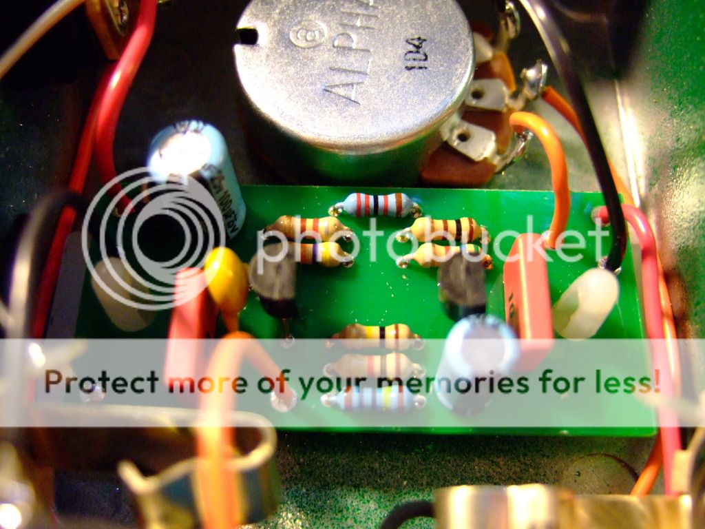

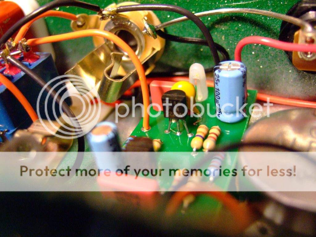

engineelite
Posts: 37
I did my best to get the correct colors off of the resistors but sometimes the blue/purple/black look VERY similar. The only resistor in question in my mind is the bottom metal film value because the the color stripes were much more transparent and difficult to see than the others. The pot is 50K linear.

Nocentelli
Posts: 2211
Joined: 09 Apr 2009, 07:06
Location: Leeds, UK
Has thanked: 1115 times
Been thanked: 939 times
Post by Nocentelli »
:applause: Great pictures, thanks. That totally makes sense: Looks like the only change from what we've got already is an 820r instead of 1k coming of the +9v supply and going to the collector resistors... ...and that extra 5-band resistor at the top of the board :hmmm:
phibes
Posts: 1107
Joined: 10 Dec 2008, 01:17
my favorite amplifier: HIWATT motherfucker!
Location: United States
Has thanked: 75 times
Been thanked: 189 times
Post by phibes »
Nocentelli wrote:and that extra 5-band resistor at the top of the board :hmmm:
LED resistor
