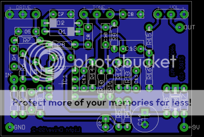

Welcome, I have some gut shots of the Top Tone Light Drive (thanks to one kind person). I believe this is a Pete Cornish SS-2 without an input buffer. I have traced the pedal and I can post the schematic but I'm not 100% sure and only a few values (don't remember which) are read from the gut shots.
EDIT:
I don't have the pedal unfortunately, only gut shots.
Here is the schematic.
TopTone Light Drive cornish.PDF
Schematic
(47 KiB) Downloaded 962 times

If someone could look at the values and schematic- does this make any sense? And pot values are:
Volume A10k
Drive C50k
Tone B25k

Are you sure R11 is connected to 9V? Would make more sense to be connected to Vb.
I find it odd that he used 2 LM741s instead of an LM1458 or JRC4558. Would've made for a more compact layout.

From what I see on the last picture where I marked +9V and GND rails r11 is connected to +9V. But as I wrote earlier it would be great if someone could check the schematic and values.

Did up the schem and a quick single sided 1590B sized layout in Eagle. Part numbering matches that of the schem in post 1. Only difference is that the two LM741s have been replaced with a single dual op amp.
Schem: http://dl.dropbox.com/u/8021347/Light%20Drive.sch
Board: http://dl.dropbox.com/u/8021347/Light%20Drive.brd

MWichni wrote:If someone could look at the values and schematic- does this make any sense? And pot values are:
Volume A10k
Drive C50k
Tone B25k
The values look good,
that 50K drive pot gives a max op-amp gain with R7 being only 470ohm of 212 and it is also reverse log and that is perfect.
C5 across the drive pot is a difference to a normal distortion+ and would give some high end boost if the drive pot is turned down and bypassed by the cap giving the higher frequencies more gain and presence, pretty cleaver as a stock distortion+ sound pretty muddy at low gain settings.
The Tone pot also looks good.
The second op-amp looks a bit strange to be, especially the connections around R12, R13 and C12, but it could work that way,
I'll have to think some more about it...
One question do I understand it correct that you only used the pics to make that schematic?
and the pic from the pcb side with some values given and some unknown, has that the same part numbering as the schematic?

Values marked on the picture is read from the pictures. I had some resistor color codes read down by the owner and from that I made my guesses. Hope it helps. And yes I traced it only from the pictures.

I can't confirme the schematic.
There are too many connections were I can't make out if it's a resistor or capacitor and what value they have.
For example C1, D1, D? look a bit wrong if that C1 is supposed to be the C1 input cap from the schematic
and if D1 and D? are the 1N270 clipping diodes...
Also the value of the input cap seems to be a bit too large

Don't compare parts numbering from schematic to the layout because they are not the same. I'm sure that D1 and D? are clipping diodes because this make sense, right? If you will trace this from what I drawn and from the pictures you will come close to the schematic I ended up I think.

The output stage doesn't make much sense as drawn - I think it's probably a bit simpler:
The 1M coming from the junction of the two 10k resistors would bias the first op-amp input OK. The two 1M bias divider resistors can't be used with a 10µ capacitor as drawn - the time constant would mean that the bias would drift up towards 4V5 over several seconds!
It seems to be a pretty crude design (in common with a lot of this guy's circuits - usually built on the basis of "what you don't put it can't go wrong"!). The use of a pair of 741 op-amps is probably in an effort to use the limited bandwidth of this IC type.b The problem will be that it will be noisy (the 741 really hisses badly by modern standards!).
