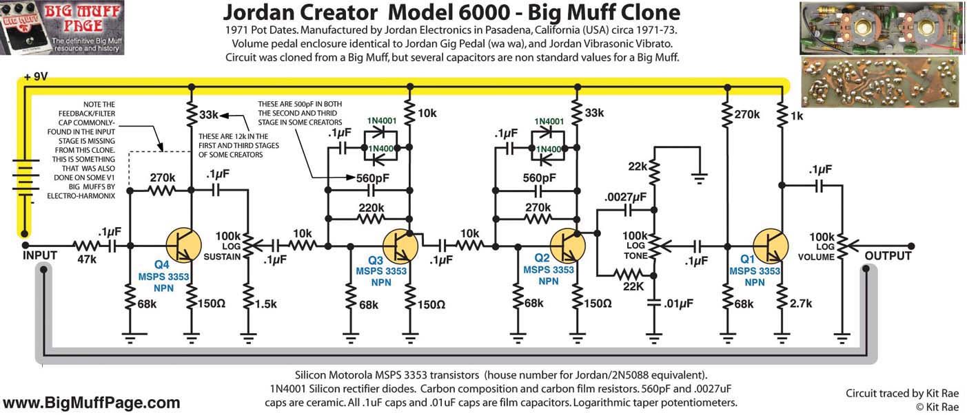

What kind of diodes does the Jordan use? Do you have a schematic for it?
Re: Big Muff vero - different variants
Posted: 11 Mar 2012, 05:09
by Kitrae
It uses 1N4001 Silicon rectifiers.

Kitrae wrote:It uses 1N4001 Silicon rectifiers.
Here's mine.
http://www.kitrae.net/music/Images_Secr ... ematic.jpg
Nice work Sinner :)
The transistors are drawn wrongly - they should be NPN or they're not 2N5088 equivalents.
Incidentally, my Jordan Creator has a 12k collector resistor for the final stage and for the first clipper stage, uses some weird Fairchild transistor (each one has an hfe of ~250), and has negative ground.

by Kitrae
Yeah, I need to clarify that whenever I get this on the website. Clones should be made NPN with 2N5088's. The SPS 3353 was apparently a house number. Whatever those original transistor part numbers were is unknown, but I suspect it was a 2N5133 equivalent, or even a 2N5133, if Motorola was making the same spec trany back then. EHX did the same thing with the Fairchild 2N5133's marked with the FS36999 house number. Both right around 1971 incidentally.
Mine are PNP, but the transistors have the same number. I know of two other Creators with the same tranys, but they are NPN. I saw a Motorola list with NPN 2N5088 as a modern equivalent for the SPS 3353, making mine the oddball. I think that list was dug up by Chris Mahoney when he made his clone.
I have seen 12k collector resistors in two other Creators, and two others with 500pF filter/feedback caps rather than 560 in the second and third stages. Seems Jordan was not only cloning, but taking lessons on consistency from EHX...or it could have just been a running change.
