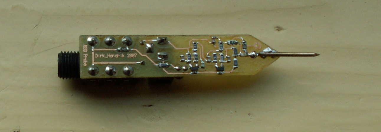

OK, something different but handy as hell!
If there's something I really can's stand it's the adjusting the bias of BBD based circuits in order to tune the distortion to minimal while coping on the BBD's output. The signal is sampled and when scoping the output of a BBD one has to "see" the correct signal (from a sinewave generrator) "through" the samples. pretty tough to determine hom much distorting there's left. The rough tuning is easy but the details are not.
So, I took the output filtering of an Ibanez AD-9 delay and made a small probe containing this circuit:

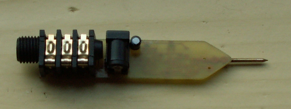

and the bottom where the electronic parts live:
When hooking this up to your scope and probing on the BBD's output pins one will get a perfect, filtered signal to see which is really easy to adjust.
And.... it's a giveaway:
http://www.dirk-hendrik.com/temp/bbd_probe.pdf
(5 pages long including board layout and silkscreen)
the transistors are emitterfollowers so, in this case, the type barely matters.

I looked at the reticon specs and tried to understand the purpose of filtering the output signal. I just can not...
May I ask here for a tiny explanation? I think I'll try to make a through hole version of your probe to check my SADs, but don't really know what could be needed...

IggY
Posts: 126
Joined: 18 Jul 2007, 13:28
Post by IggY »
o.k. last try: http://acapella.harmony-central.com/sho ... ?t=1867732 click to start the first appearing youtubeclip
and watch and listen only for the first 35 seconds:
imagine the triangle wave to be the clean audio which is getting to be truncated by reducing the rate of sampling
which again is similar to reducing the clockrate of a BBD.
The stairsteps that appear is what is being filtered by the outputfilter to smear the stairs to a smooth slope like at the start of the clip.

I never worked with a scope before, so i have some stupid questions:
I connect the BNC out from the scope to the input jack of the probe ?
Does this probe need 9 volt power ?
Do i need an additional grounding clip on the probe ?
