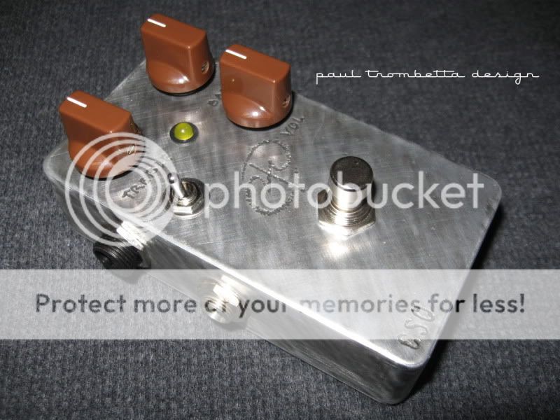

Joined: 31 Dec 2007, 19:00
Location: fuckin' space
Been thanked: 16 times
Post by Lawnchair »
I use 2n2222A in q1 and q2 and a BC109 for q3 in my CSO. Love it.

Post by irmcdermott »
lawnchair, curious to know what the switch is doing on your build?
