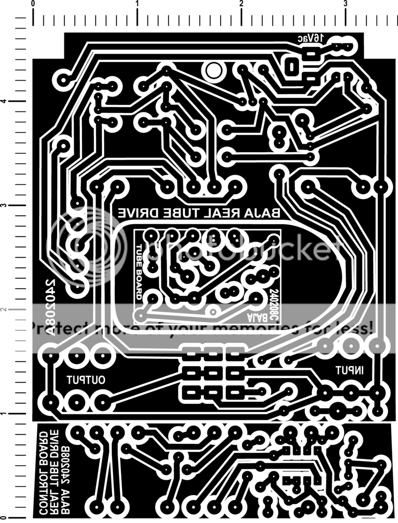

Some pictures of a finished pedal - the customer chose the name and colour :wink:
https://i197.photobucket.com/albums/aa2 ... 00001s.jpg
https://i197.photobucket.com/albums/aa2 ... 00002s.jpg
https://i197.photobucket.com/albums/aa2 ... 00004s.jpg
Important: I have found that there is a difference in metal thickness between the Hammond and NSC equivalent cases ( available from Pedal Parts Plus).
Originally i took measurements from the cheaper NSC case which has a much thinner walled and top panel thickness than the Hammond.
When i tried to fit the assembly in a Hammond case, I found that i could not fit the bottom panel. So, after a wee bit of cursin' I dismantled and trimmed the tube and control boards ( I had to remove at least 1.5mm) i refitted the boards and this time as you can see the case lid was able to fit properly.
I will redraw these boards for those who wish to use Hammond cases, but i would strongly suggest usingf the cheaper thinner NSC cases if you want to use the existing board layouts.
Sorry for any inconvenience.

Hello again :wink:
Please use the following PCB and Layout artwork if you intend to use the Hammond 1590BB case
https://i197.photobucket.com/albums/aa2 ... ammond.png
https://i197.photobucket.com/albums/aa2 ... Layout.png
If you are using the NSC equivalent 1590NS case then please use the original artwork posted earlier.

Looks cool Baja! How did you cut the tube hole in the large board?
I drilled a couple of holes and fitted a smallhobby hacksaw blade through then carefully cut it out ( the tube board). i use a 3/8 round file to smooth the rough edges off the opening - just one way of doing it :wink:

Bajaman, can you perhaps also post the schematics
Sorry about that - I have not posted them as yet - i need to tidy up my drawings - will post them soon. :oops:

Hello folks - sorry for the delay - I forgot :oops:
here is the schematic at long last. :wink:
