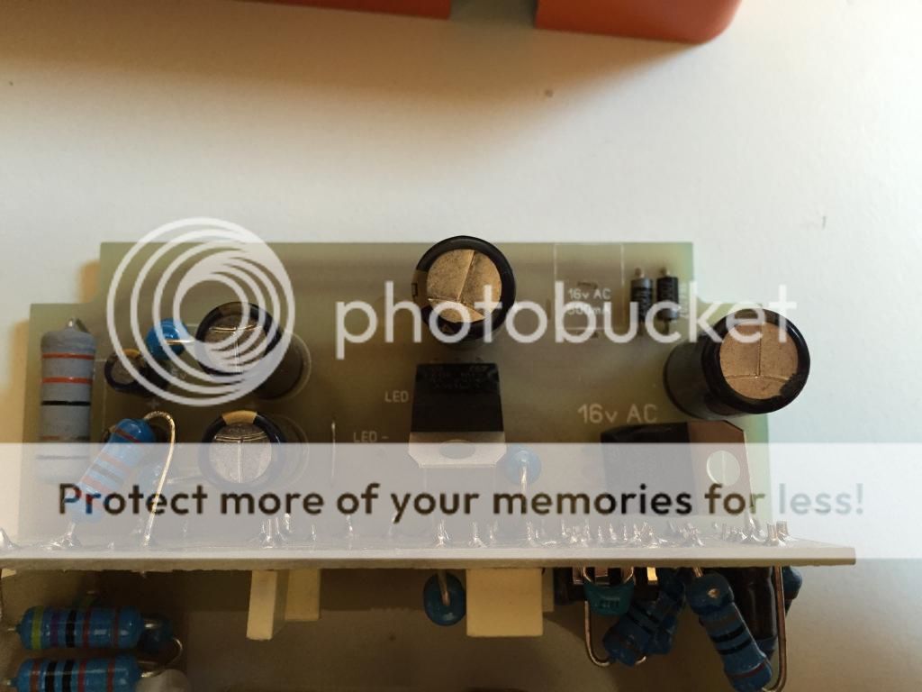

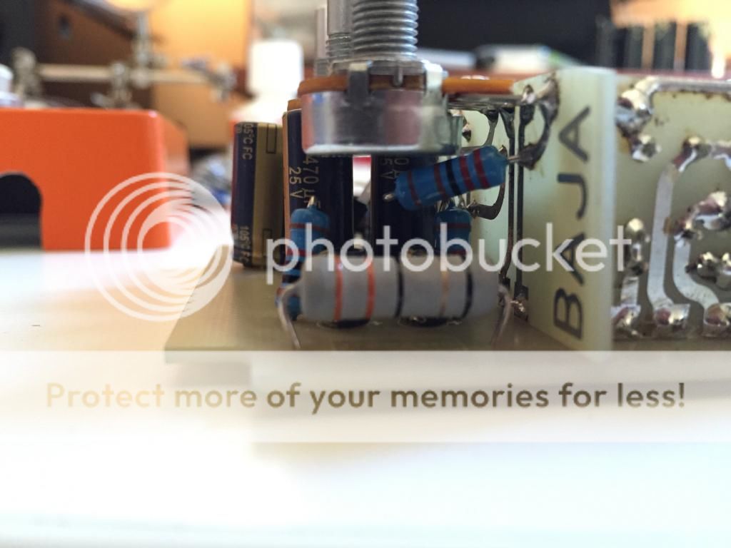

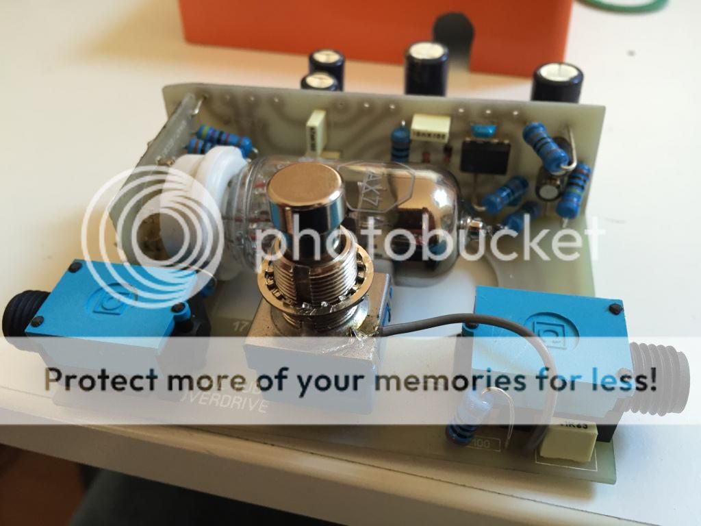

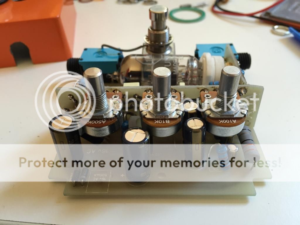

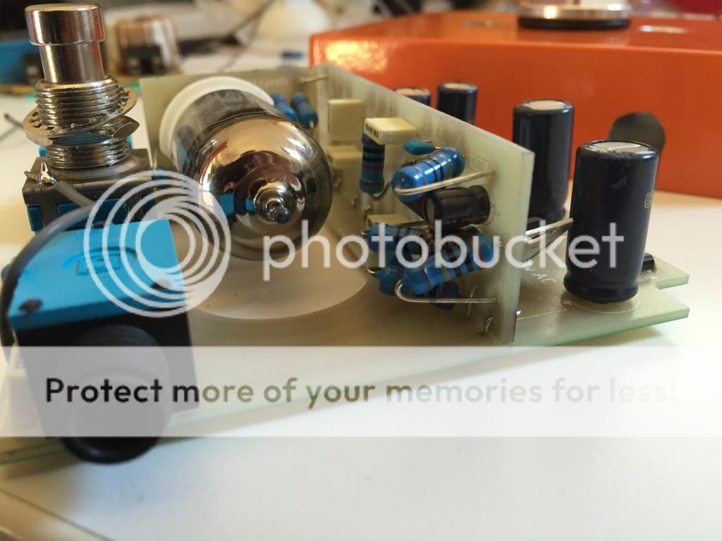

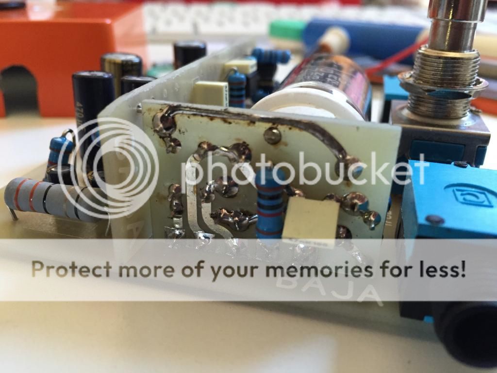

Some build pictures, this is my first stompbox project ever. I didnt know 1W resistors are this big, they were about the same price so i guesed "1W can handle more so why not?" Haha. I had to file down the top of the two little pcb's or else it wouldbt fit in the Hammond case, i will put a little bit of plastic on top of the tube pcb so the exposed tin line will not short circuit with the case.

So i tested it, my home made ac adapter with emi filter gives 15.4 volt when the tube drive is connected. The 5W 33Ohm resistor gets so hot that i can barely touch it for 1 or 2 seconds, is that normal? I measured the ac going between pin 4 & 5 it only measures 10.4 volt, so do i have to get a different ohm 5w resistor?
I hope i didn't mess up this build, haha :p

bdevogel try a 27ohm 5w resistor - ideally you want to read as close to 12.6v AC on the tube between pins 4 and 5 :thumbsup
incidentally as bdevogel has found out, the pcb is designed for NSC 1590NS NOT Hammond 1590BB enclosures - The NSC enclosure is a lot cheaper - try http://www.pedalpartsplus.com if you cannot find it anywhere else. The NSC has a slightly thinner wall thickness for the top of the enclosure. ;-)

I started measuring every connection on the way between the 7915 and the tube and i found that a capacitor wasn't soldered correctly, you could barely see it. So now i have something like this: Pin 1 and 6 have about 9 volts, pins 2-3-7-8 have roughly -13 v average.
Also now with the 27Ohm Resistor i still get only 11v on the heater. With an emi filtered ac power of 15.4v~
Also when i touched the l7815cv i burned my finger, so i guess i'll have to replace that one haha. Must have been because that one time when i accidentally short circuited it while measureing voltage haha :slap:

When the Baja Real Tube Overdrive circuit is operating normally, the LM7815,and LM7915 three terminal regulators should not get very hot, you should be able to put your finger on either of them for at least a minute without burning yourself, they should only be warm to the touch, if either of them are getting very hot that would indicate that they are faulty, or there may be a short-circuit on the +/- V supply rails somewhere, a shorted power supply filter cap on the output of the regulators would also cause that.
