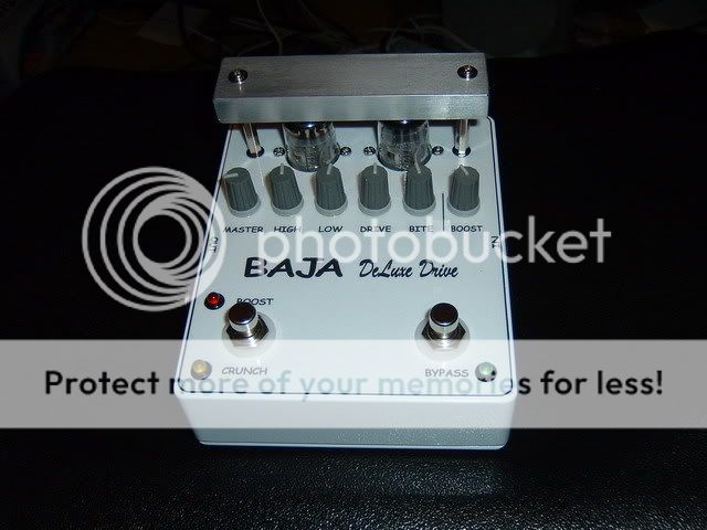

bajaman wrote:Let me emphasise - this is not really a tube circuit design in as much as the tube is being operated off 24vDC and not 240 - 350vDC as in normal tube design practice.been looking for a good reason to get into tube circuit designs
The starved plate voltages coupled with the high gain Tubescreamer type op amp drive circuit, gives a completely different overdrive characteristic to the full voltage all tube design as shown in the link below![]()
https://i197.photobucket.com/albums/aa2 ... 1small.jpg
Bajaman
Are you willing to share the secret of your BAJA DELUXE DRIVE pedal shown in this picture??
Ryanuk

Not at the present time sorryAre you willing to share the secret of your BAJA DELUXE DRIVE pedal shown in this picture??
- ryanuk
- Solder Soldier
No worries - didnt think you would otherwise you would have linked it earlier in the thread. Thought I'd ask anyhoo !!bajaman wrote:Not at the present time sorryAre you willing to share the secret of your BAJA DELUXE DRIVE pedal shown in this picture??![]()
