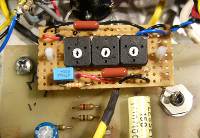

For testing, I'm using a US strat with a 500k vol. and no tone pot, Duncan Custom shop 78 in the bridge and DiMarzio Cruzer in the neck. JMP-1 into 5150, into a 1x12 theil cab loaded w/ a WGS ET65. (plenty of bass). I'm also switching between a WGS Green Beret in an open back Vox AC15H1TV combo. For clarification, any time I say "5150", It's through one of those speakers sense that amp was voiced for greenback based speakers. I then switch between a Mesa Simul-Satalite 1x12 w/ a WGS Vetran 30 in simul-class mode, running a pair of JJ 6L6 GCs and a pair of Tung Sol EL34s. Vitage 30 based speakers (like the Vet) , in an open back 1x12 would be very lacking in bass. So if I could get that to sound good, I know I'm there. I set the JMP-1's output to Instrument level for the 5150 because that loop was designed for instrument level stomp boxes and it always sounds best that way.
I tried boosting the range of the bass with 2K2 at R177 last night, and reducing the range of the middle at R158 with 8.2 and I have to say I'm liking it a lot better. It's not a radical change either, but fuller sounding indeed!. I'm able to A/B quickly between the 5150's pre and Marshall. The Peavey still has more bass. It took a 1K8 to match the 5150's low end and to be honest, I'm torn between that and 2K2 at R177.
If I can get it sounding good between those two power amps and three speakers.... then I'm probably coming up w/ something most people would like.
These two mods are sounding good with the factory presets as well, making them fuller sounding. I'm noticing a better "feel" as well
I'm swapping back and forth, between the stock components to the new ones with alligator clips. This bass boost is not flabbing out either. It's still pretty tight.

Unanswered question : So all you would change is the cathode reistor ? Yes you can, without any problem. I doubt though if that would change anything, cos the tube is (IMO) in operating range and not in overdrive.Funkystrings wrote:

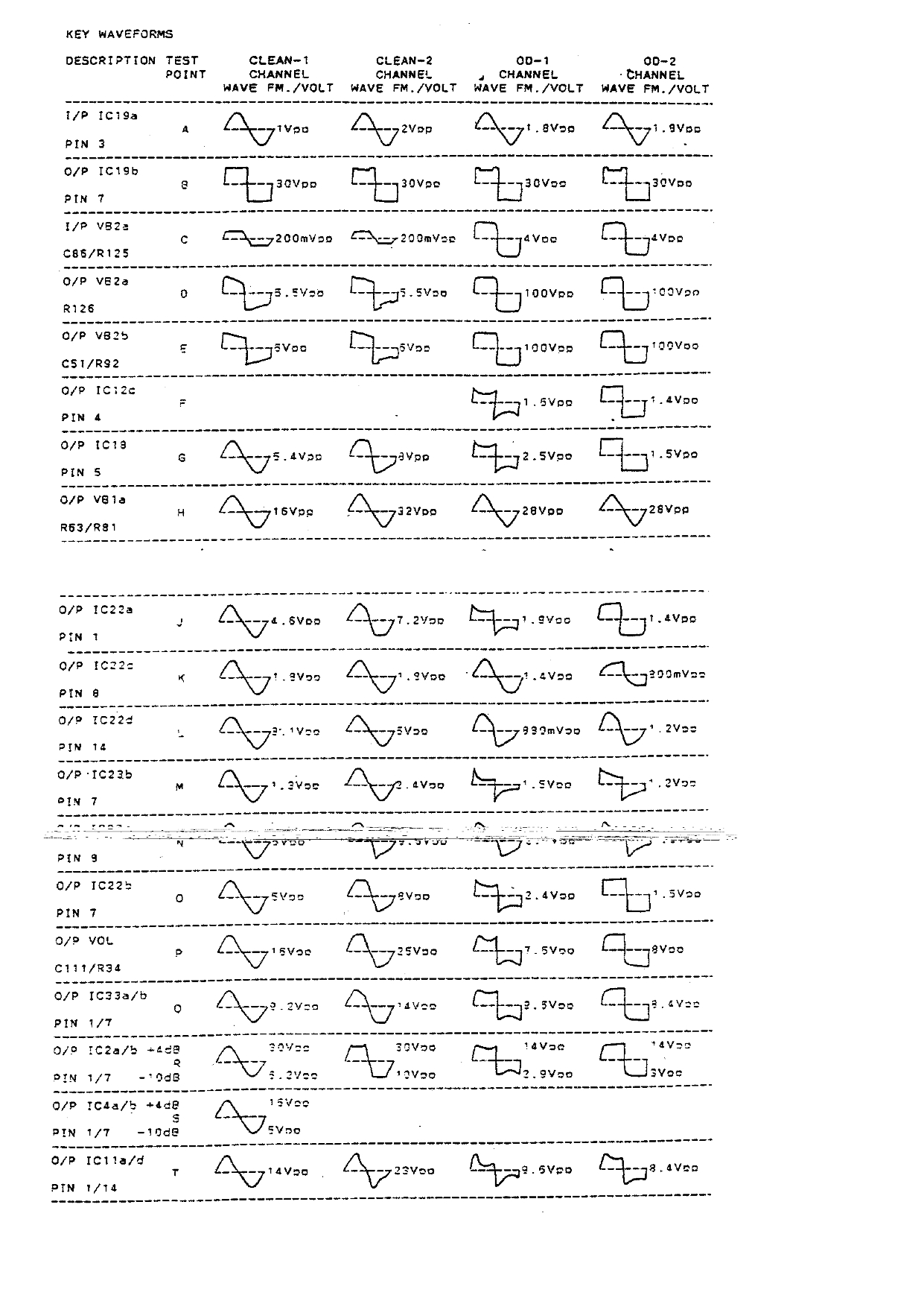

Unanswered question : The clean channel is a hybrid, but the tubes play a major role in the stages sound. The solid state only handles the CL2-filtering and the gain. The rest of the tone is created in the tubes.
Q1 : This is pretty much what tschrama did on replacing R84. C56 is the brightcap although it is preset to a fixed value
Q2 : Just a long shot ; Try bridging C121 with a bigger cap. That the highpass filter at the input that works for all channels. If that doesn't work there are options for the separate channels , but I will have to look into it.
Just put some thought to this. If you want "out of control" overdrive, forget about it. The fizz, hiss, or whatever you'd call it, is not going to happen with just one cathodefollower, which in essence is just one valve stage.Funkystrings wrote: So my question now is this; Could I first just try boosting that 12ax7 slightly for the OD sounds? and then just lower all the gain settings in my presets? Or would that blow something out? I'd like to make the JMP-1's overdrive a little more "out of control" like the 5150, and utilize it's OD 12ax7 tube the way the infamous "fifth tube" of the 5150 did sense that's why it was put there in the first place in both amps. I just think the tube in the JMP-1 should be a bit hotter so that if the gain was maxed at 20, it would then be a little "out of control" and start hissing like a snake the way the 5150 does when maxed. thus forcing one to simply turn the gain down on the JMP-1 so that say, maybe 10 would now have the same signal to noise ratio of the stock maxed 20 setting. Just to see if some mojo happens in that 10 region. Would that be simple enough? how would you go about this?
The fizz, whatever is created by distortion-chaining, actually five stages for 5150.
Just biasing the tube hotter is not going to change anything, because it is well within it's operating range and therefore not distorting. To take it into (full) distortion, you will have to increase gain of the stage by also putting
in a cathode bypass cap (I used 1 uF, but you "bassfreak" could try 22uF) which will inrease gain from 43 to 70. (not sure, but check my first post for this thread)
Stock, the output voltage at C51 is 40 * 1.8V = 72 Vtt. Pushed into full drive the output voltage will rise to 160 Vtt (=HT). That's 108 Vtt at R91 fed into IC12b which is specified at 11.2 Vtt.
Personally I would change R91/R92 just to be on the safe side.

Tubetinkerer makes some excelent suggestions and analysis.
-Whether the OD tubes is clipping or not, is not relevant. You wont hear the clipping of the tube, because there is an element later in the signal chain that clips earlier (IC12b).
-Increasing the bass EQ, makes the bass more and more honkey, as you loose more and more deep-bass. A fixed deep-mod is possible, most practically in between IC12b and IC12c. Lot's of options there. I would suggestest a bass-boost as in the Peavey Rockmaster preamp (and maybe JSX, XXX).
-I would suggest C119 (22n) to 10-15n, and C116 (68n) to 10n-15n. This way you get a even-tighter, and normal tight sound.
-The jmp-1 OD channel has no bright cap around the gain pot. I don't know if the IC allows you to put one in.
-You can get , pretty much, as much gain as you want, but you will need more pre clipping tone shaping... more bass attenuation and prolly more trble attenuation too. maybe lower R189 (15K) to 7K5?

[quote="tschrama"]
- As with all distortion chaining you will hear the clipping. The tube distortion will color the sound one way or another. Solid state clipping induces even harmonics.
The tube can be biased to induce uneven harmonics. (See V2a in the 5150, (SLO-100, Dual Recto) although taken to extreme there)
If early clipping of IC12b would be the only sound-shaper, then the rectifier-bridge and tubestage would be pointless altogether. That's not the case.
-Intriquing, so I checked. The gain Pot (IC24b) is a resistor array. So I am pretty confident that you can put a bright cap either between pin 2/3 or pin 6/5.

Here's a jmp-1 waveform chart from the service manual, got it off the web ages ago and forgot I had it…
Just a thought for a mod, you could replace R122 & R121 between IC12 pins 2 & 5 with a tonestack using trimmers like in the Dumble HRMs. A dual rectifier tonestack could drop in there nicely for a contrast. I did this just as an experiment in a Musicman amp I've got (FMV tonestack) and it works really well:
Cheers Tubetinkerer for sharing your mods and ideas, they have got me thinking, and made me want to have a look at the clean channel sometime (you weren't wrong about the biasing etc earlier either…
). I've just noticed you said your jmp-1 has a lack of range in the tone controls and sparkle in the cleans, usually these have loads of eq available, mine can get way too bright at extreme settings. What amp/speakers are you running it through? Are you using the line outs and not the emulated speaker outs into the amp?
I may try tweaking R142 to reduce the overall gain slightly. However, I find mine sounds superb and gets used loads in the studio, and bizarrely often sounds more "hot-tubey" than some expensive rigs - for clients who want that Marshall sound. Don't underestimate the effect of the power amp/speakers/cabs on the tone. Mine is run through a 9005 all tube power amp (recapped, microphonic ceramic caps in signal path replaced, and biased nicely) into a couple of custom closed back 1x12 cabs (Eminence Wizard & Governor speakers). It gets put in the live room and cranked up loud
