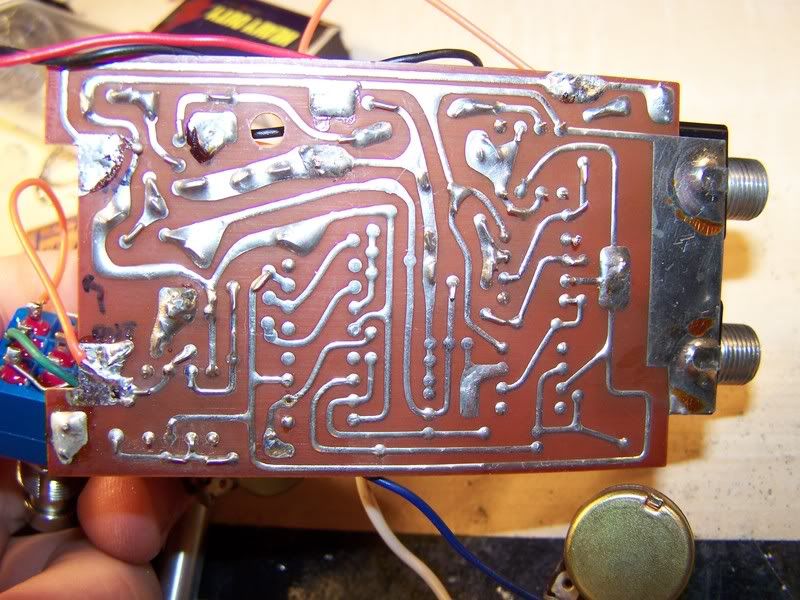

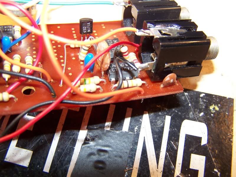

Shockingly great sounding pedal from Memphis. Guts and PCB, I'd like to trace a schem.
Interesting to me is the number of wasted traces and empty holes. Clearly they manufactured 2 or 3 boards and built different effects by populating different areas, but i wonder what else they made with this board.
EDIT: forgot to mention that this is AFTER i already true bypassed it, it had the usual spdt switch from the 70's.

The way the jacks are mounted has a striking resemblance to the Coron Jet Flanger & Filter Matrix!
- analogguru
phasers....Interesting to me is the number of wasted traces and empty holes. Clearly they manufactured 2 or 3 boards and built different effects by populating different areas, but i wonder what else they made with this board.
The picture below is from a Coron 70 "Space Machine".
When you compare it, you will see that you have a mistake in your wiring in that way that the capacitor beside the IC near the footswitch shouldn´t have a contact to footswitch...
I think you will hear the ticking of the LFo at the moment...

hmm, quite confused by what you say guru, as the original switch quite clearly connects there and I received no ticking, actually oddly enough the pedal was quiet as a mouse, and pleasingly choppy.analogguru wrote:phasers....Interesting to me is the number of wasted traces and empty holes. Clearly they manufactured 2 or 3 boards and built different effects by populating different areas, but i wonder what else they made with this board.
- analogguru
The wire of the switch is not only soldered to the according pad it is also soldered to the neighbour-pad of the capacitor.

oh i see what you mean. no, picture defect. the two pads are not actually connected. by the way, those are some odd part numbers, what do you think suitable common replacements would be? all the IC's are the same and all the trannies are the same. possibly a 741 variant for the IC's? seems to be in the family. I'm figuring likely the two trannies would be subbed with general purpose NPN trans, i can't imagine they are fets or special transistors.analogguru wrote:The wire of the switch is not only soldered to the according pad it is also soldered to the neighbour-pad of the capacitor.
- analogguru
The diode is a Zener-diode probably 4,7 V or 5,1 V - must be written on it.
The transistor marked K92 is a 2SK 92 - a Fet comparable to 2SK 30A
The other transistor is a PNP-trannsistor - can´t read what´s written on it, probably Axxx (=2SA xxx).
The chips are NEC µPC 741 C which are 741.
I am missing some component values, especially from the capacitors. If I get them I can finish the prepared schematic.

I've given the pedal back, but have easy access to it. i'll try to get it back within the next day or two and get you what values you need. Then once you have a schem, I'll have a try at the layout. could probably sub in 2n5457 for the fet, no?analogguru wrote:The diode is a Zener-diode probably 4,7 V or 5,1 V - must be written on it.
