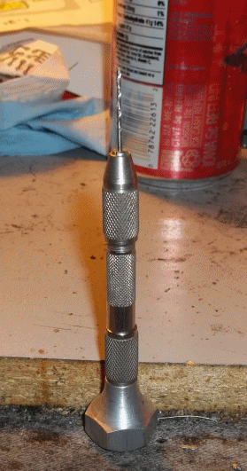

mysticwhiskey wrote:Yep, I've done this on a number of occasions and it seems to work well. I use pins from right-angle header connectors to solder to the PCB:
Great idea! only problem is the pots I got from tayda... alpha ones with the sweet little plastic dust/conductive covers, dont fit into the holes of the vero and perf I received from them. Do you have to sand down the terminals to get them to fit? I was also thinking I could enlarge the holes on teh perf but I thought that might ruin the copper traces. eh?
Nah, I do that with perf and vero all the time.

Thats a sick little hand drill! whered you get that? or what size is the bit? id love to start using vero strips for my pc pin pots

That hand drill is called a "pin vise" and they have em at about every hardware and hobby store. They're phenomenally useful for vero/pcb stuff.

Got a bit size that works well for vero and perf?

claytushaywood wrote:Got a bit size that works well for vero and perf?
depends on the size of the strips and spacing and all that. The pin vise that I bought is just a chuck that holds bits, so I robbed whatever old bit i had lying around that was big enough to easily remove all the copper on vero and used that.
