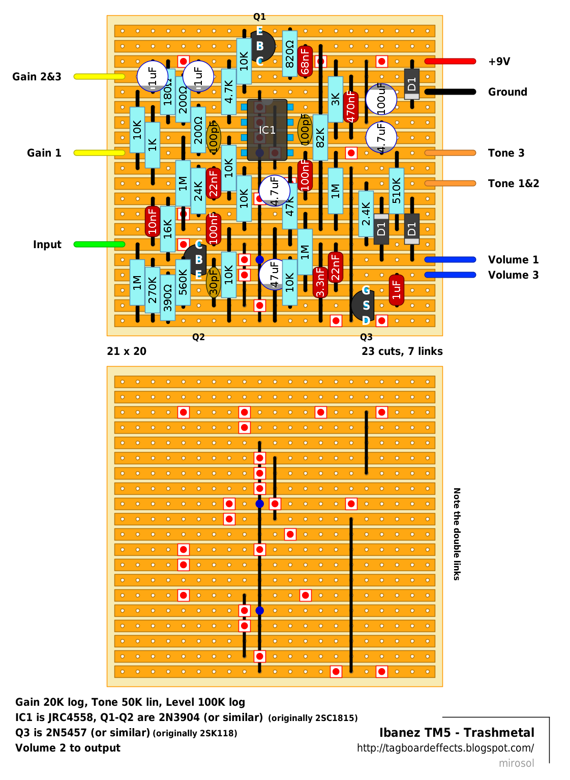

Here's my verified stripboard layout:
http://2.bp.blogspot.com/-F-32aUySF-Q/U ... hMetal.png
IMO this is really great distortion. Severely underrated.
+m
+m
BIG + 1!
Hats off to you guys that can trace and build these things on stripboard! :applause:
Re: IBANEZ TM5 PCB - GUTS
Posted: 19 Jan 2013, 19:00
by czech-one-2
mirosol wrote:Here's my verified stripboard layout:
+m
I see you swapped the 100k gain pot for the 20k volume. I did the same for mine after reading a post from Analogguru. Theres still more than enough gain on tap,and lots of volume if you decide to use it for lower gain applications. Nice looking layout by the way!
