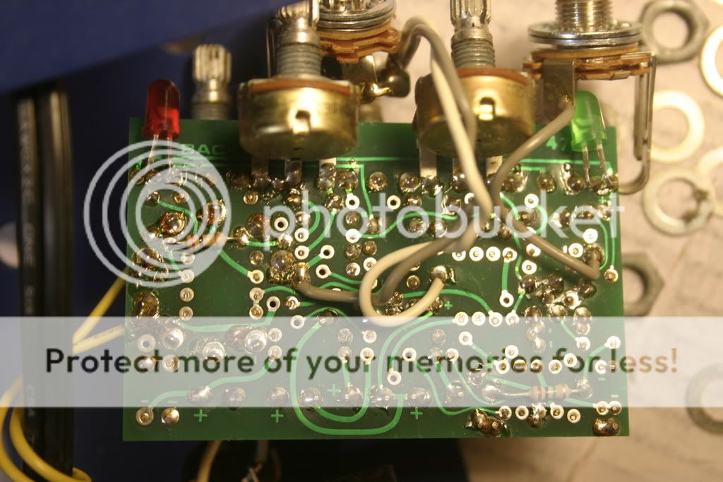

Here are some gut shots of my TubeWorks Bluetube pedal.
Some notes:
* the two ICs are Ti TL072
* the two FETs are labeled J112
* all the caps are rated for 16v
* the transformer has no discernible identifying marks
* there are no SMD components
Here we go with clickable thumbs:
Nice.
It appears to be almost exactly the same circuit as the TW303 I put up earlier today. You could use the TW303 schematic as a guide and fill in the blanks where the values are different. I'm assuming that majority of the value differences will be in the tube section and tone controls. The rest of it is pretty much just buffers. There might be a difference in how much gain is available in the opamp stage right before the tube, but that would most likely be affected by either the value of the pot used for the Gain control or the values of the padding resistors in series with the signal after that stage.
The plate load resistors look like they are probably the same value - 68K - but maybe different cathode resistor?
It will be nice when we can have the complete set of all the different Tube Driver pedals traced out... especially since they aren't made anymore (except for the six B.K. Butler builds personally each week!).

SoulSonic, you inspired me to post the guts!
I also have a TubeWorks 100w head (which is tube pre-amp and SS power amp), so if you think that might help, I can post some shots of that as well.
