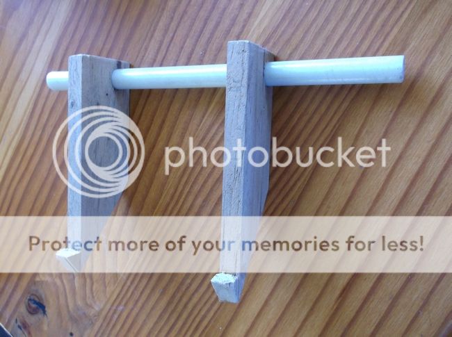

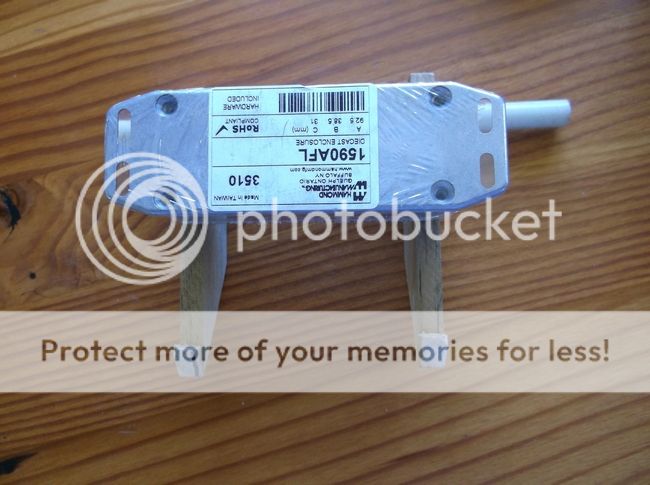

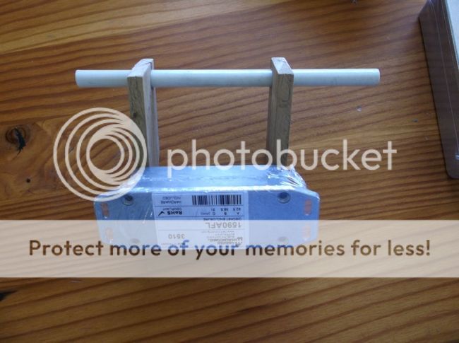

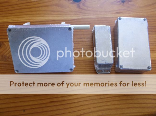

9odd minutes later and here's what I came up with.. by no means on the same quality scale as yours but I'm all about function over form.
the pedals being so much lighter, there's really only any need for one dowel. I had no dowel as such about the place, so cut a piece of this fibreglass rod (used for an electric fence).. the thinness of the 'support' wood ('stringers' I guess :lol: ) means I could move it in between knobs if the enclosure was larger than 1590BB and still support the thing I reckon.
anyhoo.. here 'tis.

Fantastic job Rocklander. :applause:
Like I said in my early post, simple is best.
You certainly don't waste time when you've got a bee in your bonnet !
Congratulations mate. :thumbsup
