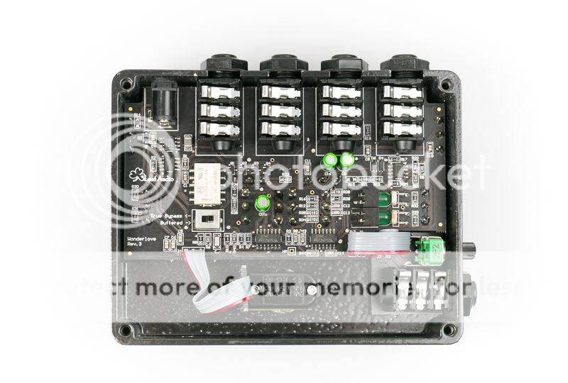

The filter section of the Wonderlove is very similar to the Meatball/Mutron. The detector circuit is somewhat unique. It's all surface mount - I'd be seriously impressed if you guys traced it. Here's a gut shot:

Well now, that looks very good!

Thanks. It's been a while since I designed the PCB, but from looking at it I can tell you that all the stuff near the power jack is related to the relay switching (the big white box, of course, is the relay). One of the quad op amps on the lower edge of the board is the state-variable filter which is controlled by the LED/photocell arrangement on the right. No goop, so anyone who's motivated enough could probably trace it out.
