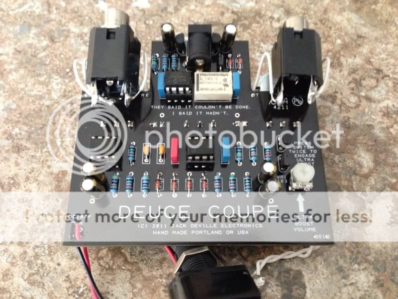

Got this one in on Wednesday and got around to tracing it last night. Think it's correct, but I'm not 100% on the boost control and the tone control. Also, the PIC part is pretty worthless for anyone who doesn't code, so replace the Q1 and 2 with a mechanical switch if you're gonna build it otherwise. Also of note is that the board is 4 layered, so all connections were sussed out with a multimeter's continuity function. I'll post the diagram I used to mark connections later.

Wow!
You're pretty good!!
Nice trace man.
Notes:
-Charge pump IC is an LT1054, rather than MAX1044
-Diode cathodes are connected to PIC rather than anodes.
Again, nice work man.
:applause:

Ah yea, forgot to change the naming when cleaning it up. I think the diodes are a screw up from copying my hand notes, but I threw them away after redrawing so I dunno if I got them right initially or not. Thanks for the corrections. :thumbsup New schem is attached.
I quite like this one as well. Nice range to the tone control. Useable all the way up and all the way down. Just wish it had a bit more gain, so I might put a 100k pot in for the gain control. Healthy amount of output for hitting the input of my amp as well. Doesn't seem to like hot pickups as much as single coils and PAF types, but I find that the norm with soft clippers, at least for my purposes.

Cool use of the boost mosfets and microchip!
So the player just double taps for a different mode? Nice work on saving a foot switch, real estate and still giving two functions. Wondering what the easiest range of tap times is to be able to hit on the fly while still being quick enough to allow fast bypass on/off action for short passages between clean and dirty. I'm assuming you allow it to stay in ultra boost mode while bypassed and it engages back in ultra mode?

The manual details the operation of the switching system:
http://jackdeville.com/jackdeville/manu ... manual.pdf
Its much easier and more intuitive than it would seem. Essentially:
-One tap to engage/bypass
-Two taps to toggle between Ultra and Drive
If you are up for a fun exercise, draw up the truth tables, state diagrams and k-maps for the system. Its not too bad with only three states. :)
You will see the logistical challenges involved with a system like this.
And thanks for the compliment! I think the MOSFET application is pretty cool too. 8)

What does Q3 serve for? Muting?
mmolteratx
Posts: 508
Joined: 19 Dec 2009, 01:50
Has thanked: 93 times
Been thanked: 618 times
Post by mmolteratx »
mrkaploca wrote:What does Q3 serve for? Muting?
Yea, pulls the output to ground during switching pulses. Pop prevention.

What about mosfet body diode? This kind of configuration starts clipping signal above 0.4V. I suppose it could go with this particular circuit (as this is a clipping circuit) but if it's a part of Deville clickless system, i don't thing it would be a wise thing to use mosfet as a switch...

So are cathodes or anodes connected to PIC? Jack stated it's cathodes, but your new schem. states it's anodes... :scratch:

Can anyone tell me what P$1 and P$6 represent? Also, I do not see the Takamisawa relay on the schematic. Any help would be great.

jsrfo wrote:Can anyone tell me what P$1 and P$6 represent? Also, I do not see the Takamisawa relay on the schematic. Any help would be great.
I believe P$1 and P$6 are connected to the coil of the relay.
P$1 and P$6 are +/- of the relay coil. Was too lazy to rename them when creating the part.

Post by lukatosh »
Hello!
from what i've understand...
Q1 and Q2 works as a switch to activate the boost function of the pedal?
can I implement that using a 3pdt??
i can omit Q3, R11 and C7 since this components works as a switching pop prevention ?

Post by Jack Deville »
Yes and yes.
