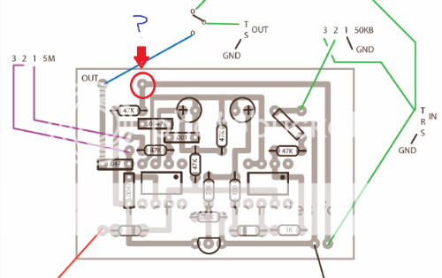

I am one step closer...After realizing there was no change when I pulled IC2 or the transistor, I checked voltages and there was nothing getting to either. It turns out the ground wire wasn't pushed into the breadboard deep enough.
I was sure that would solve the problem, but not yet. I still get an overdrive type distortion and the 5M changes the bass & treble. Now, the 50K has an effect. It turns the volume off at 100% clockwise with little change the rest of the turn.
IC1 has ~ 4.5v on lugs 2, 3, 6
IC2 has ~ 2v on lugs 2 & 6
Q has ~ .4v on the base and 0v on C, which is obviously a problem

2n5088negrosinfe wrote:My friend Lucifer: which transistor did you use?LucifersTrip wrote:
viewtopic.php?f=19&t=2221&start=40#p174554
what are your voltages?
IC1: 8.24 on 2; 4.10 on 3, 6 & 7LucifersTrip wrote:2n5088negrosinfe wrote:My friend Lucifer: which transistor did you use?LucifersTrip wrote:
IC2: 1.73 on 1; 8.24 on 2; 1.87 on 3 & 6
Q: .32 on B, 0 on C & E
i'm using a non fresh 9v battery (8.77v)

did you measure correctly? pin 3 is grounded on IC2 (bottom on schematic).negrosinfe wrote:IC1: 8.24 on 2; 4.10 on 3, 6 & 7LucifersTrip wrote:2n5088negrosinfe wrote:My friend Lucifer: which transistor did you use?LucifersTrip wrote:

Are you also using 741's?
I'm using UA741C, and the measurements were incorrect... this are correct:LucifersTrip wrote:did you measure correctly? pin 3 is grounded on IC2 (bottom on schematic).negrosinfe wrote:IC1: 8.24 on 2; 4.10 on 3, 6 & 7LucifersTrip wrote:2n5088negrosinfe wrote:My friend Lucifer: which transistor did you use?LucifersTrip wrote:
IC1: 4.10 on 2 & 3; 4.11 on 6, 8.25 on 7
IC2: 1.87 on 2 & 6; 8.25 on 7; 1.82 on 8

that is pretty much what I have (my battery is 9.6) so it accounts for slightly higher voltages...Either our 741's don't work or we both misinterpreted something & wired it wrong. I think I'm going to pull this off the breadboard and quickly try a Dr Q.negrosinfe wrote:I'm using UA741C, and the measurements were incorrect... this are correct:LucifersTrip wrote:did you measure correctly? pin 3 is grounded on IC2 (bottom on schematic).negrosinfe wrote:IC1: 8.24 on 2; 4.10 on 3, 6 & 7LucifersTrip wrote:2n5088negrosinfe wrote:My friend Lucifer: which transistor did you use?LucifersTrip wrote:
I never build from layouts (only schematics), but that "?" you are pointing to simply looks like just a normal corner where the author forgot to remove a solder point?
I forgot to mention that the 50k pot has no effect yet, i think we must wait to see Rhandy's SFM video...LucifersTrip wrote:that is pretty much what I have (my battery is 9.6) so it accounts for slightly higher voltages...Either our 741's don't work or we both misinterpreted something & wired it wrong. I think I'm going to pull this off the breadboard and quickly try a Dr Q.
Can i post pics of my SFM?
(sorry for my por english...

mine lowers the volume slightly, then turns sound off at full clockwisenegrosinfe wrote:
how did you get this? shouldn't it be 0?1.82 on 8

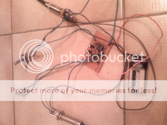

your english is excellent...of course, you can always post pictures...clear close-ups are best. maybe someone will catch an error.Can i post pics of my SFM?
(sorry for my poor english...![]()
I forgot to mention, I tried different op-amps (tl061, tl071) with the same pinout but gave me 6 - 8v on IC1 and no sound.
admittedly, i know very little about op-amps...i build primarily ge fuzzes
Ok, here are the guts:
